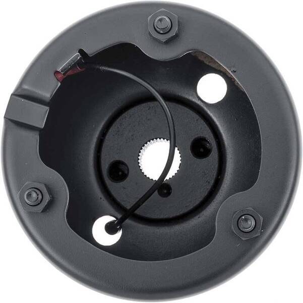

yeap, normally steering wheels (and adapters ) got a hole that could get to reach the turning switch lever with a long screwdriver ( turning switch bolt is also hex head ). Dunno if it's their function, but is there. So maybe removing the steering wheel is not necesary just the horn assembly.
this is a tuff wheel adapter which got two of these and one of them is used for the horn switch wire
