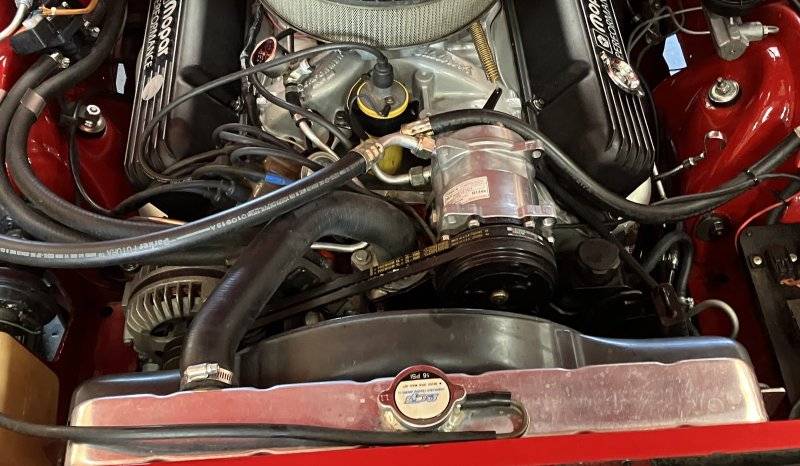

I have noticed that my alternator often fails to keep up when I'm at idle with the headlights and A/C going.
The car.....
I have a rebuilt 63 or 65 Amp alternator, whatever the highest one was for these cars.
If I am idling with the headlights on and the basic stereo on, it isn't terrible. Maybe 11.5-12 volts? At 1800 and up, the rate jumps to the 13.0 and up range. Cruising at 70 mph and 2200 rpms, it is solidly in the 13.7-14.0 range whether I have headlights on or not. I do have relays for the headlights, bought from FBBO member CrackedBack.
There is something about the A/C though. That fan motor really sucks the juice. At stoplights at night, headlights on, A/C going and brake lights on I'm dropping below 10 volts. I have no electric fans or fuel pump drawing power so why is it dropping so much? Can a stock alternator be rebuilt to put out more power at idle?

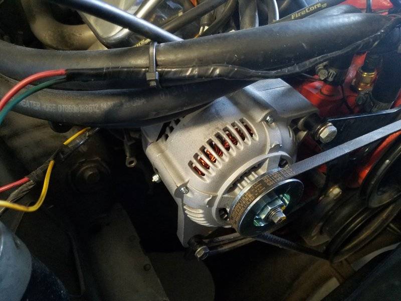

Randy/ 1 Wild R/T suggested this:
These brackets allow the use of a Toyota based Denso 60 amp alternator. That is lower than stock but it probably puts out more power at idle. I'd need something with a 2 groove pulley since the A/C compressor needs 2 belts to avoid slippage.
I'm not looking to jump right into this, I'm just testing the waters,
If you have dealt with the low output at idle, what did you do?

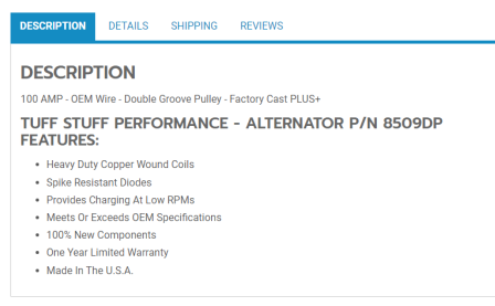

Is wishing stock look and no brackets deal.. Tuff Stuff 100 amps. (There are 120 units at this moment too)
This is the cheaper source I have found on the web. I whish exactly this one for me but I have a lot of priorities right now to cover right now, and since my Charger is in pieces in Venezuela yet I think will take some time to take care of this
Alternator Tuff Stuff Performance 8509DP - Pace Performance Parts
Sure they are squareback alts, not completely correct for your 70 thought, but at least 80% correct look. 100% if you don’t look at the rear case LOL.
