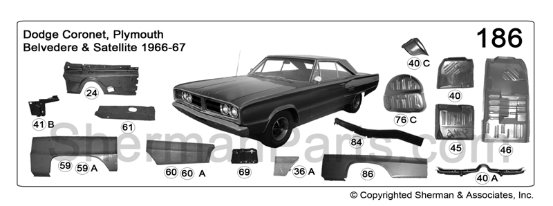

I have been looking for a replacement panel for my 67 satellite, and have found nothing. it is a very common rust area and I thought it would be avail in repro. this is the area just behind the rear wheel well, it is not rusted on the inner trunk ext. any help would be great, should I just fab some sheet metal?

Got Sherman panels for my `66 Belvedere II in 2010. Body guy said they were the best he had seen as far as re-pops...every bit as thick as the original metal. I used panels 59 and 60. I initially tried a full lower qtr (from JC Whitney) but it was flimsy thin and did not match the contour of the body at all. Don't know about panel 86. They didn't have it available when I ordered mine. Someone else said you can get Sherman panels a bit cheaper through one of the parts wholesalers (RockAuto?). Maybe a search for 'Sherman" on this site might give up the post that stated which wholesaler. Good luck!
thank you all for the insight. I was using the classic ind. catalog, and they seem a little short on some parts.
