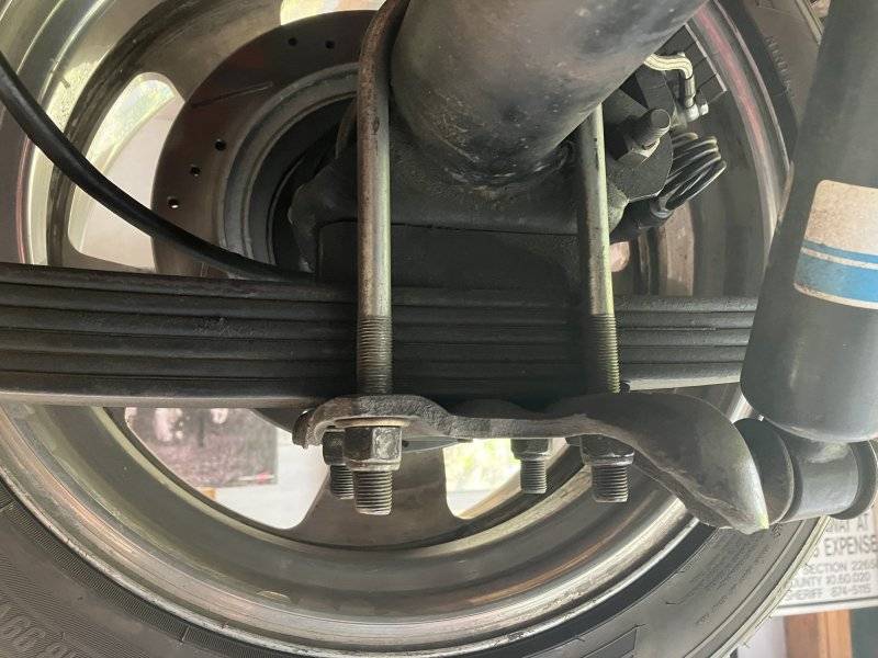

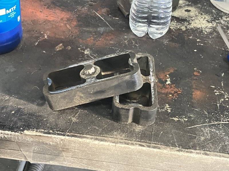

I had one inch lowering blocks in my car for years....
I took them out a few months back because I wanted to raise the car up a bit.
There were never any problems with drive line angle, pinion angle, vibrations or anything.
A 1/2" or 1" block shouldn't hurt anything. If you want just a 1/2" I would hack them out of a piece of 1/2" steel, drill a center hole, and bolt them into the spring pack.

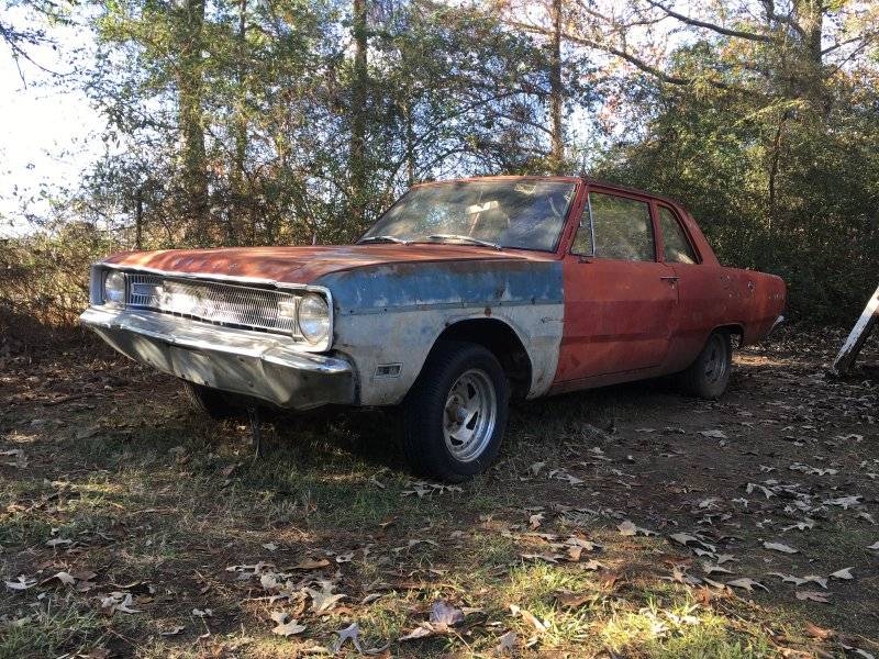

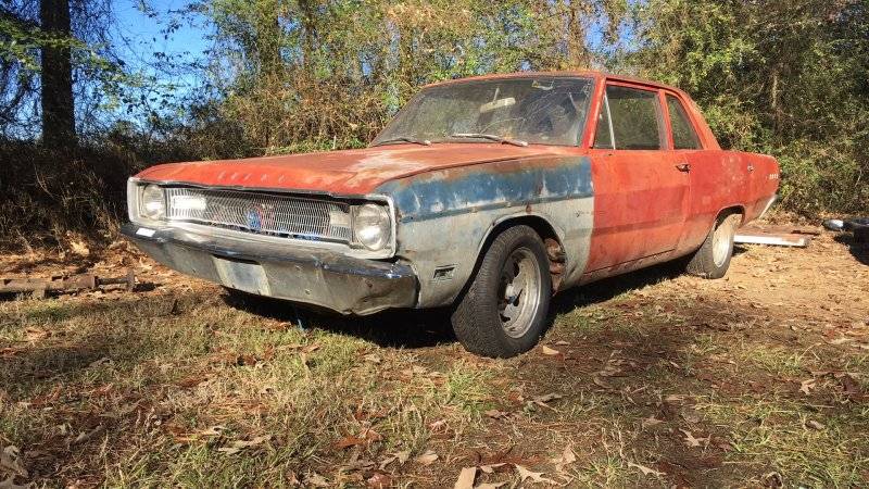

Here's my old '67 Dart before the altitude adjustment...
And after...
I think I actually cut a 2" aluminum block down to a 1" for this one. I definitely don't recommend trying that at home unless you have a mill to make the cut square. :eek:

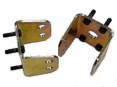

Why? The spacer mimics the suspension being lower. If the mounting points of the leaf springs were changed, that would affect the pinion angle.

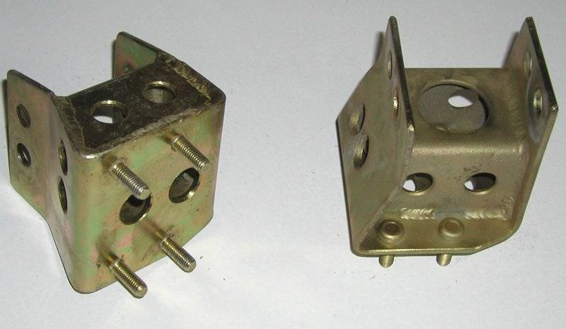

I've changed the mounting position at the front of the leaf spring using hangers like these:
That lowered the car but didn't cause any issues. I don't drag race though so my springs don't see the same shock. I have short and wide tires for better handling. They don't grip in a straight line like slicks or a taller tire with a thicker sidewall. Better traction may have highlighted an issue if there was one.

Well, I’ve been running 2” lowering blocks for about 7-8 yrs and they have worked great. The blocks do not affect your pinion angle. The “2-hole” front spring perches DO change your pinion angle (that’s why I went to lowering blocks). I’m running some super cheap, off-the-shelf Autozone/O’Reilly/etc. truck “lift blocks”, which on a Mopar are “lowering blocks”. It’s nearly a perfect fit. I think I had to shrink the pins in the blocks a tiny bit (sandpaper) where the leaf spring locator pins on the blocks go into the spring saddles in the rear end. There are only 2 issues… 1. They won’t clear old school “slapper” traction bars (I went with an adjustable pinion snubber). 2. I had to substantially modify the pinion snubber to clear. I basically cut the adjustable part of the snubber (inner & outer box steel with holes for the locking pin) AND I added a smaller rubber bumper that I cut in 1/2. Done. No wheel hop. Pinion snubber maybe 1” from floorboard and it doesn’t hit the body (unless I floor it). There might be a clearance problem on a Hemi car since they get an extra plate welded in there, but neither of us has a Hemi car, so you’d be OK. The blocks cost like $35-$40 and come with longer U-bolts
Using the front spring hanger to lower the car is a better fix than lowering blocks because it improves the roll ctr of the car. Not hearsay, something i learned with the technical support of Bill Reilly at RMS while i was setting up cars to go faster than everyone else
