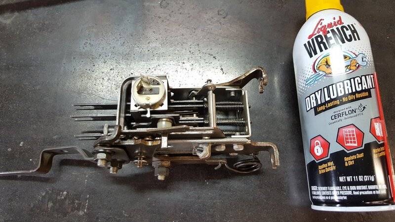

Any recommendations for lubing up the typewriter buttons while they are installed? Can you just squirt some Wd40.. on the mechanism - same for the heater vent buttons. Mine seem kind of sticky and sluggish.
WD-40 probably isn't the best thing to use but it's not too bad on cleaning things. Not sure what you could use while it's installed....
I've had good luck using dry graphite lubricant on different cables to get them working better. Lubricants like WD-40 attract dust and dirt.
The problem is probably the 50 years of dust & dirt that have accumulated over time, along with the natural wear on them.
I took all mine out when my '63 went into the restoration process.
A good soaking to remove rust, and grime, cleaned, and refinished what I could.
I also hunted down newer button slides, as the old were worn down quite a bit.
Lubed the cables and meshing parts in the assemblies.
They seem to work much nicer now, still need to road test...
Only lube I used on mine was a dry silicone spray. Goes on wet then drys leaving a protective coating with some lubrication properties. WD40 or any other oil will attract dust and dirt.

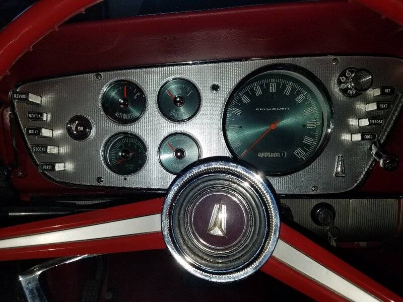

Great advice. I would have opted for the product you’re suggesting and for the reasons why you post. When I re-did mine on my ’63 a few years ago, used a Teflon spray coating product I had on the shelf after cleaning the assembly. As for button restoration, after some trial & error, having old spare buttons, came up with a method I’m happy with for the face of the buttons with fresh bright-white paint that’s easy to re-do every few years if they get grimy looking.

In any case having the button assembly out to clean it and apply a rust preventative lube will likely last another 40 years. With mine that means I shouldn’t need to mess with them again until I’m around 105

Contact cleaner works great for getting all the dirt and gum out. I use Electro Wash. But Deoxit or similar will work. Use that before you try the other spray lubes.
Contact cleaner would be great if the mechanism was out on the bench. Wouldn’t want to be laying under the dash spraying it though.

If you can remove the faceplate there is only two screws that hold the mechanism to the dash. It has enough cable to drop it out from under the dash to work on it. Have to be careful with the wire to the switch. It will need to be unplugged. It might be more involved than the Dodge though.
