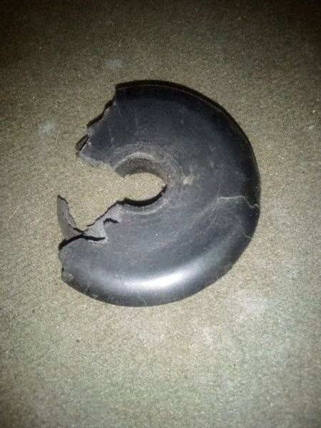

I just pulled the grommet off a set of Japanese big block Mickeys I'm working up. Old and very brittle, it didn't survive but I can look at the remnants for a part number.
Here's the grommet.

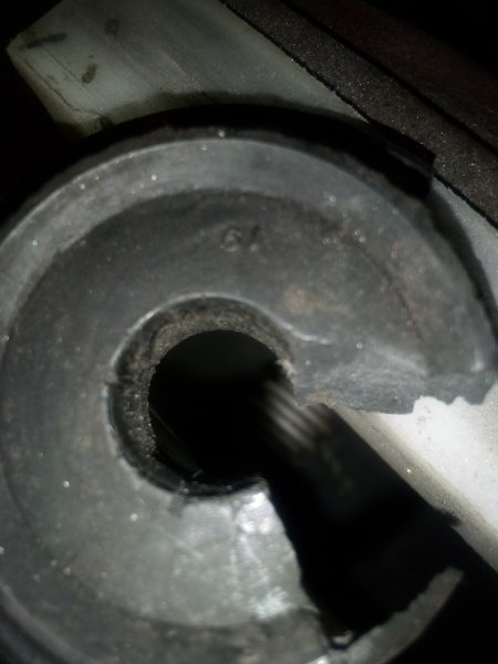

Part number 61 is all I see (no logo or manufacturer). The diameter is 2", the seating channel looks to be 5/16" and the pcv opening itself is 1/2".
I hope this helps!
