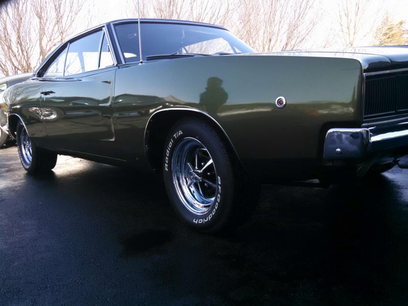

My car came with these rims on it and as you can see the center caps are incorrect so I ordered the original center caps but they don't seem to fit. I was told since these are 15 inch they are probably not stock ones. Has anyone else had an issue with the center caps and if so how did you fix it?

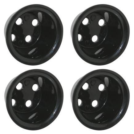

YearOne sells special retainers for use in 15" American Racing Magnum 500's.
Yea I bought these also with the cap order I placed because I did not know the caps came with the retainers and bolts, once I saw the difference I sent the retainers back for a refund and took the tabs off the ones that came with the set....

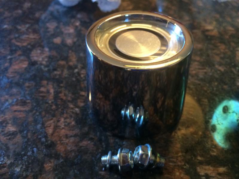

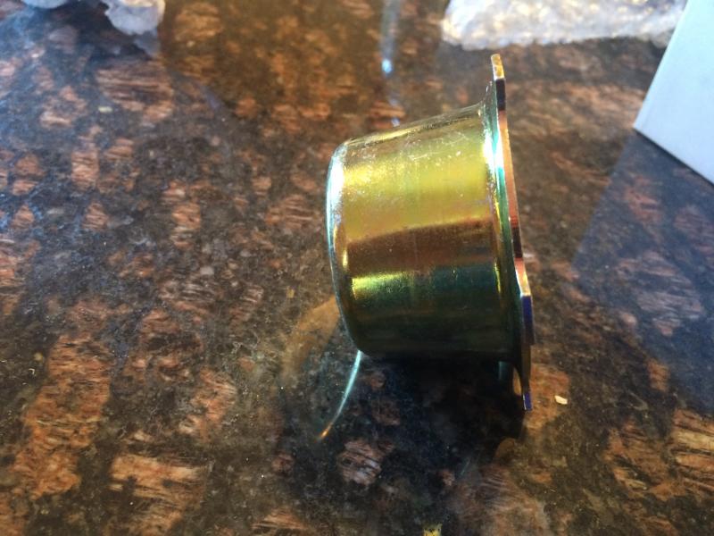

Here is a photo of the retainer and cap. Seem to be good quality. I don't have a neasurement on it. I can get that when I go home.
MoparThunder that is what the set I ordered looked like, I took and ground off the tabs on the retainers and they slipped all the way in and made the correct contact, if you don't do that it looks like you would have to purchase the ones that Car Nut is showing, which I know Year One sells.

Sorry the photo is deceiving. I double checked and they are tapered. I will get back into it this weekend and see where they might be hitting. If I have to grind them I might as well either way i will have to buy new ones if it doesn't work.

I bought these from a dealership - Mike Riehl's Roseville Chrysler Dodge Jeep Ram in MN. I found them thru my Cuda forum. They are really nice and fair. I usually deal w/ Dave in parts. Has anyone else heard of them? Is there a way to tell what make rims I have?
OK caps are on. I just bought the next longer size screw and it worked fine.
