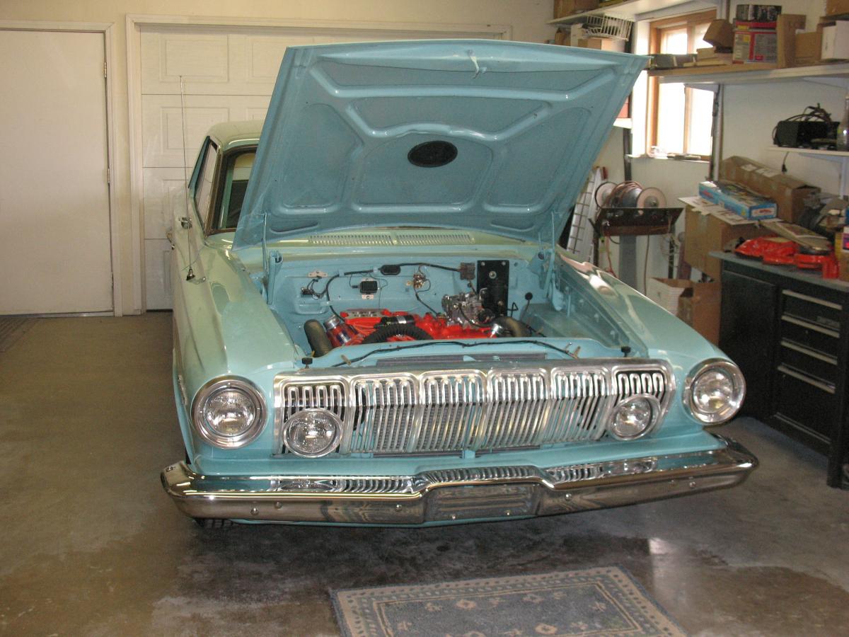

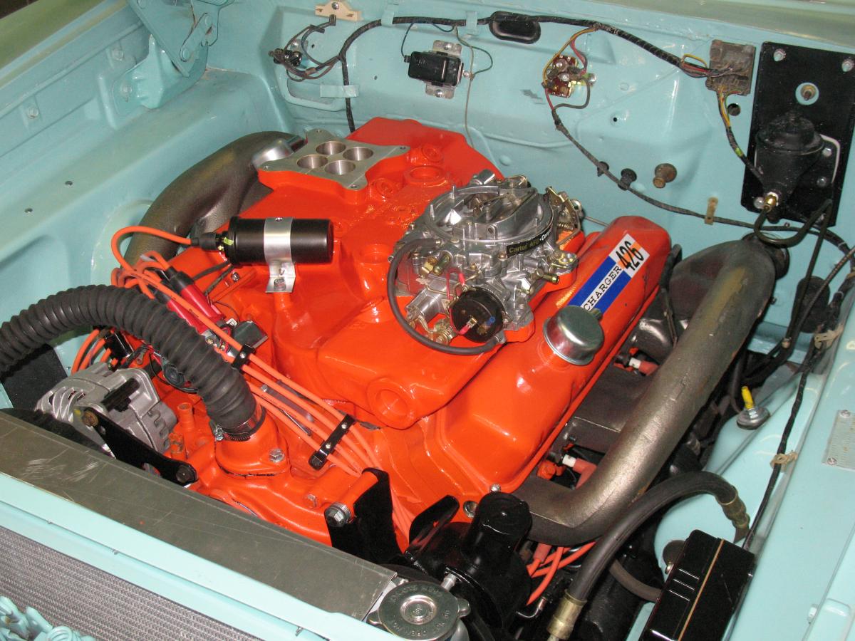

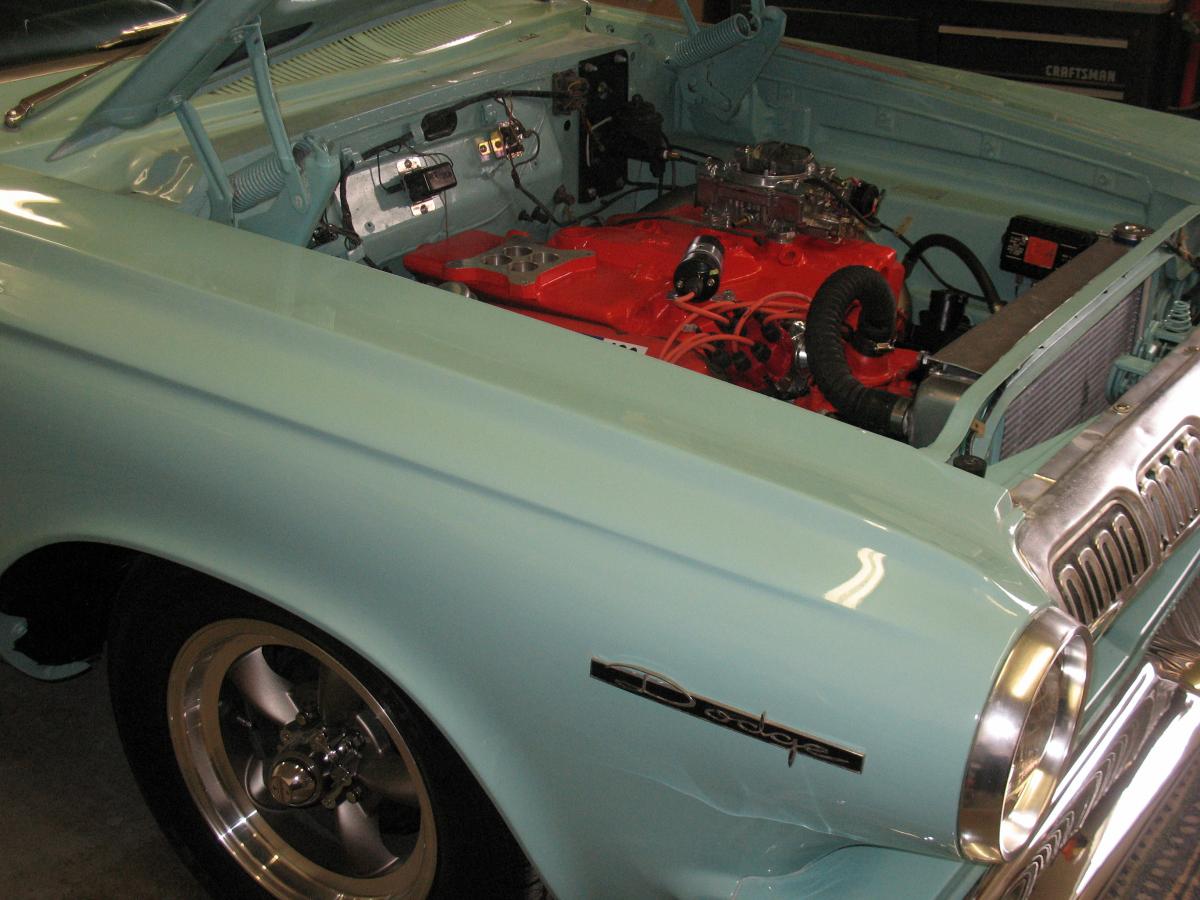

I have been away for the winter and now I`m at at home where I can get back into working on the 63. Today I fitted a max wedge intake and exhaust manifolds to the engine so now it`s on to more details. This is the fun part.
Looks like I will drive this car before the snow falls after all.

Very nice, I know that envy isn't good but....
SHEEEEEEEEEEET!!!!Looks like you could be ready to go before all the snow melts!!!!!
Looks great!!
Looks great so far... Clean work! That is a really nice factory color on the 63 too.
Saweeet!!!
Stunning car;love the color on that body. Now,that's inspiration for us to get out and work on our own rides. TO THE GARAGE! WHO'S WITH ME?
Looks like you need another hole in the hood.

Sometimes the fun part doesn`t last long enough. Today I finished mounting the battery in the trunk and running the cables and also reconfigured the trans oil tube to clear the max wedge intake manifold. All went well.
I then moved on to install and configure the engine oil dipstick only to discover that the tube is broken off just above the entry point at the block aaarrrrggggg! This is going to fun to fix.
I love that look ! Ron
lookin good, cant wait for the finished pictures ! .... about the dipstick tube, you should be able to run a sheet metal screw into the tube and work it out of the block ...

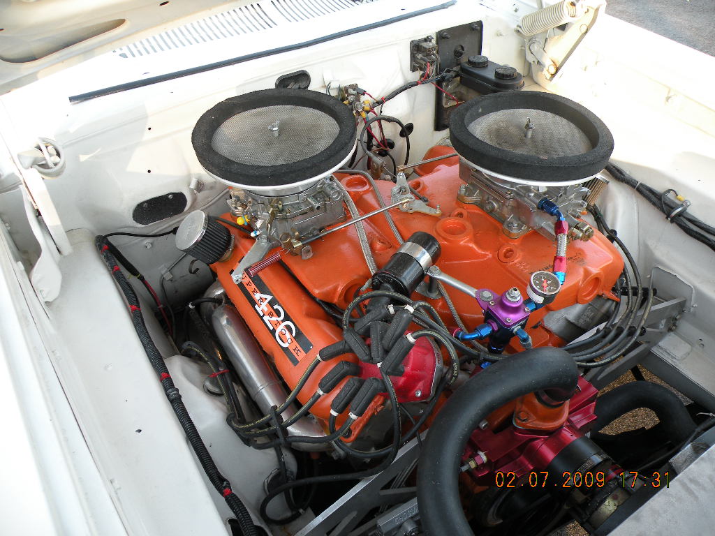

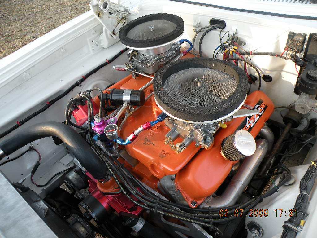

Have to share this with you....One of the guys at work "Jerry", was telling me today that while waiting for his wife to come out of the drugstore an "Old Dodge" pulled in. Old guy in his 70's got out of it and went in the store.....To make a long story short, Jerry, the guy from work got out of his car and walked over to look at the "Old Dodge" and the owner came out. Turns out that the "Old Dodge" was a 63 Polara 500 and an all original Max Wedge car. Same color as yours Bob but according to Jerry it was really rusted badly. He opened the hood and showed Jerry the engine but being a "Chevy" guy Jerry didn't have a clue what he was looking at.
