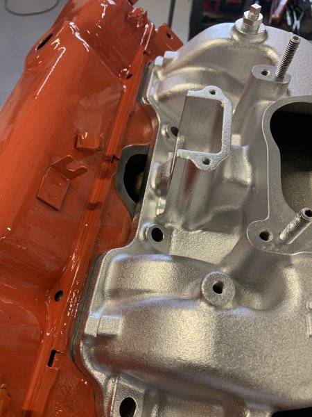

This is an Edelbrock performer 440 manifold, what is supposed to cover these heat riser ports? Are they intended to be left open?
Well, no. That open area is just, open.
Thats what I thought too, it directs warm air to the carb but I thought it would be wise to ask before I seal the valley and manifold on there- thanks
Its open like that to swallow your valve cover bolts. Don't ask me how I know.

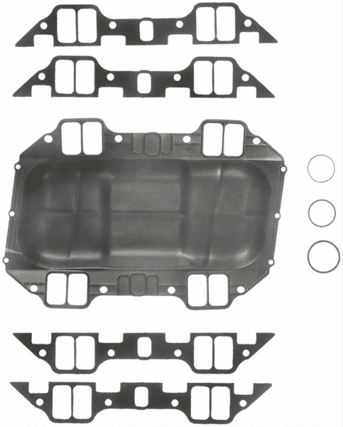

The "bathtub" (valley pan) intake gasket seals it.
