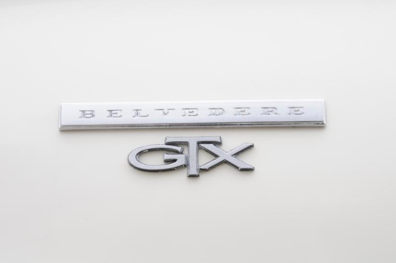

I know header are the way to go but was wondering if anybody out there in mopar land has run or is running manifolds on there a big inch 440 im building a (496) pump gas, eddy head, roller cam,motor for my 67 gtx .(street/strip). Thought it would be cool to do the sleeper thing,manifolds to 3"tti exhaust with x pipe just a thought im most likely going to go with a 2 1/8" tti step header and 3" x pipe exhaust need to make up my mind. Motor is almost ready thanks brothers _DSC6988.jpg

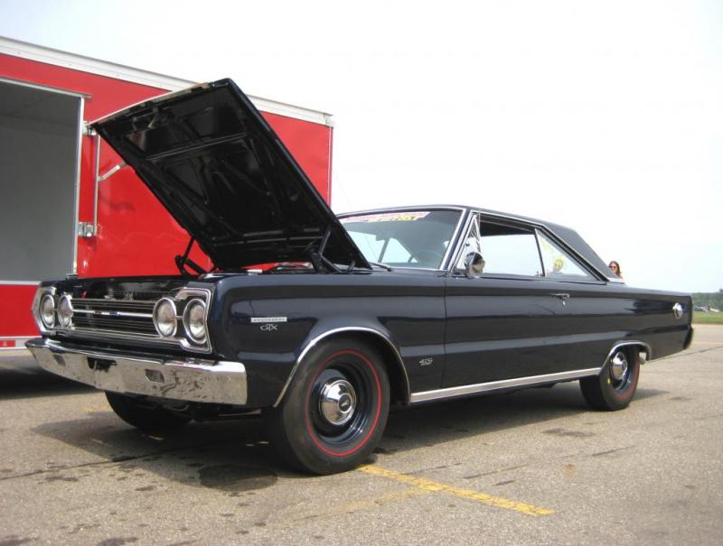

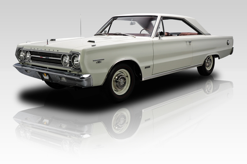

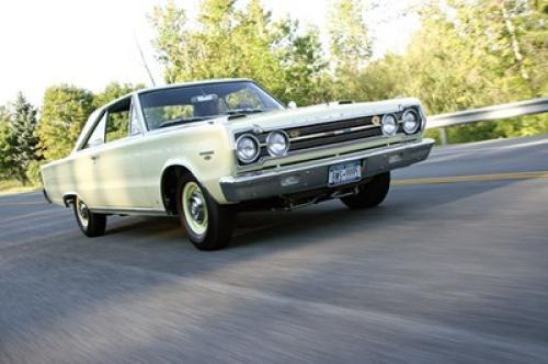

43364-130-0.jpg43363-500-0.jpg you roll up on a GTX with stock steel rims and dog dish hub caps first thing i would think is little old ladies car then upon further inspection it would become apparent that this GTX might not be the one to tangle with by the sound of them pipes179215_a167f62169_low_res.jpgfull-18308-22908-67_gtx_dark_blue.jpg
