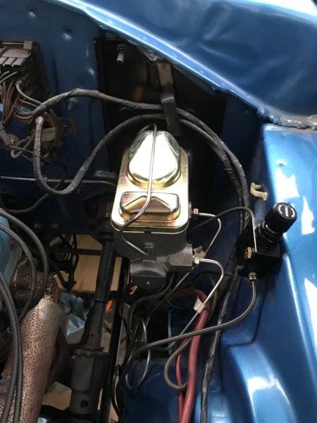

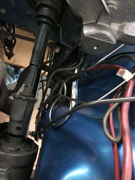

You definitely have to change the master to a disc/drum master. I used a 15/16" master from right stuff and an adjustable prop valve, both from summit. It was very easy plumbing in the prop valve. It was just 2 ready made 30" brake lines into the distribution block and out to the rear line.
View attachment 645271 View attachment 645272

I used 2 30" ready made lines and did exactly what beanhead described, except instead of a short line I used a 30" line so I could mount the prop valve higher in the engine compartment for ease of adjusting rear brake bias. I then ran another 30" line down to where the rear brake line screwed into the distribution block and used a union to join the rear brake line to the 30" line from the prop valve. I had to make a couple of bends and loops to make it fit. It's one more joint and place to leak but made it easy to adjust.

I was debating about the stock look also but decided on ease of adjustment since the master and front disc setup wasn't original anyhow. I had to stop and adjust the prop valve at least ten times to get it where I wanted it and didn't feel like crawling under the car every time.

Awesome setup I really like it. it looks clean as hell, I am just an **** moron and want to hide it :D. I will probably run the stock style prop valve and that will have to do.
The beauty of my setup is I can easily convert it back to the stock look and use an original style prop valve, which I might do down the road if I get motivated. I didn't cut or bend any of my original brake lines and the hole I used to mount the adjustable prop valve was already in the fender/wheel well.
