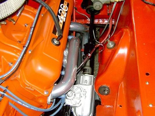

You can also do what I did. As the manual box is shorter then the power box so I bought this adapter thats about 3 inches as it takes up the extra room so you dont have to change the steering shaft. I think firm feel also makes one that has U-joints in it if you want to eliminate the stock coupler but you have to cut your shaft to install that one I believe. Its the gray adapter shaft coming right off the box. Ron

I went from power to manual and am happy with my manual steering box from flaming river. You will need an adapter because manual and power steering shafts are different diameters. As for length I just pushed the whole colum through the fire wall the 1.5" or so that it needs to reach the new manual box. Cant notice anything inside or under the hood. Cheers
