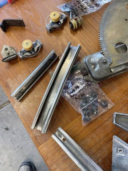

Time to start installing my window hardware. The original hardware is well original a d old and nasty. What do you guys use to clean them up? I suppose I can use simple green as I have that handy but wondering what and how you guys prepare the HW prior to installing.

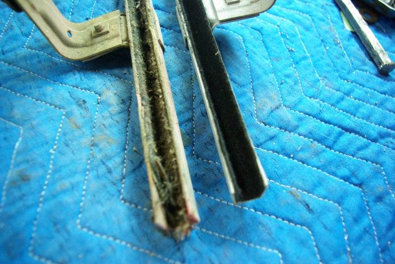

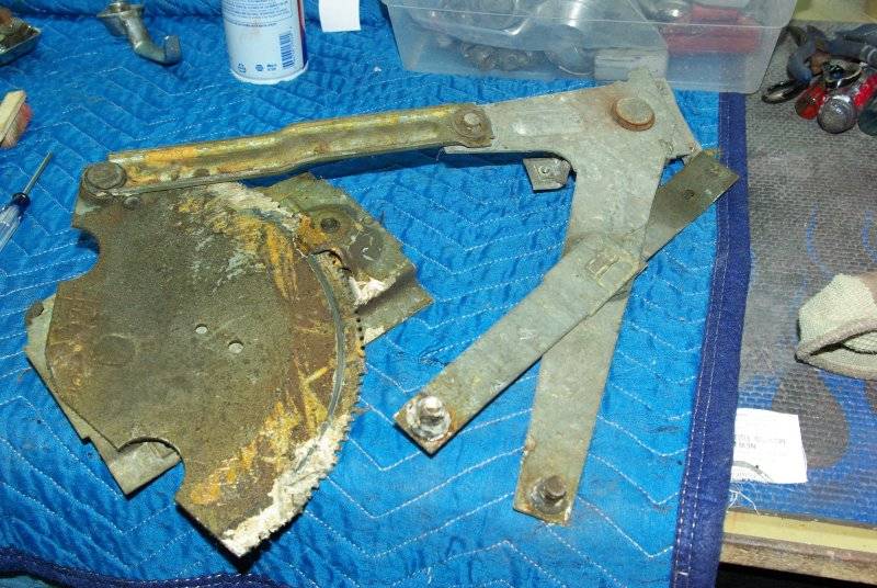

When I did mine they went into the solvent tank and then cleaned with WD40. After they were put into a vice and work thru there cycle with grease. Also after stripping out the old Channel felt I bought the new felt by the roll. remove the backing and spray the Channel with water and press it in with a bondo scraper. If you don't wet the felt it won't go in without sticking all over the place.

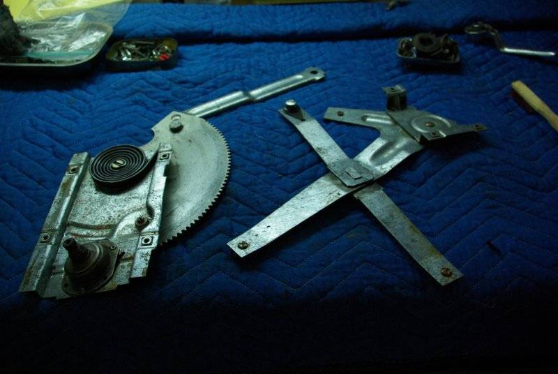

For the first pass I had access to a parts cleaner with solvent to get major crud off. Then used a degreaser (for painting prep) and a bristle brush and rag. In the hard to reach areas, an aerosol spray cleaner, like brake cleaner works well. I used Boeshield T-9 to re-lube the mechanisms after cleaning.

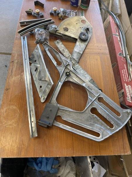

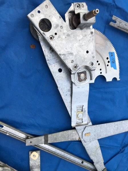

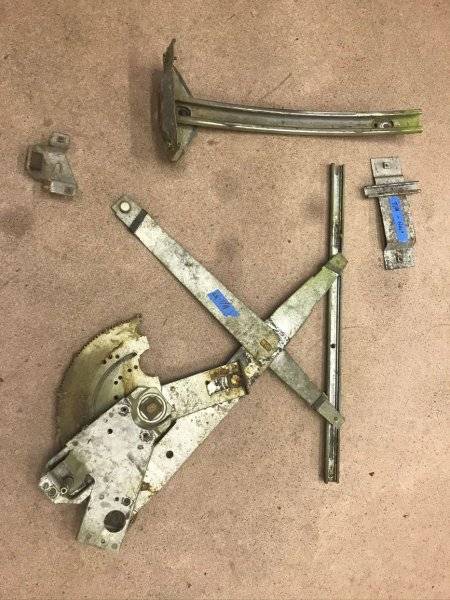

I took mine and had them soda blasted. Worked great without any damage to the galvanized plating. I did have to do some solvent/toothbrush work in some of the nooks and crannies. Before and after pics…
I took mine and had them soda blasted. Worked great without any damage to the galvanized plating. I did have to do some solvent/toothbrush work in some of the nooks and crannies. Before and after pics…View attachment 1528238View attachment 1528239

Used a solvent and brake fluid with a hand wire brush. Its good enough but not like if were blasted.

First they go for a good soak and scrub in the parts washer.
Then the blast cabinet SOLELY to remove any rust - leave as much of the original finish as possible.
Another good soak to wash out any of the blast media. Air and towel dry. Then a quick coat of "stainless steel" - just to cover any bare metal and blend with the original zinc finish.
Lastly, all the pivots and gears get a shot of "Wire Rope Lube" This stuff sprays on like water but in seconds the propellant flashes off and you're left with a thin film of clear grease.
