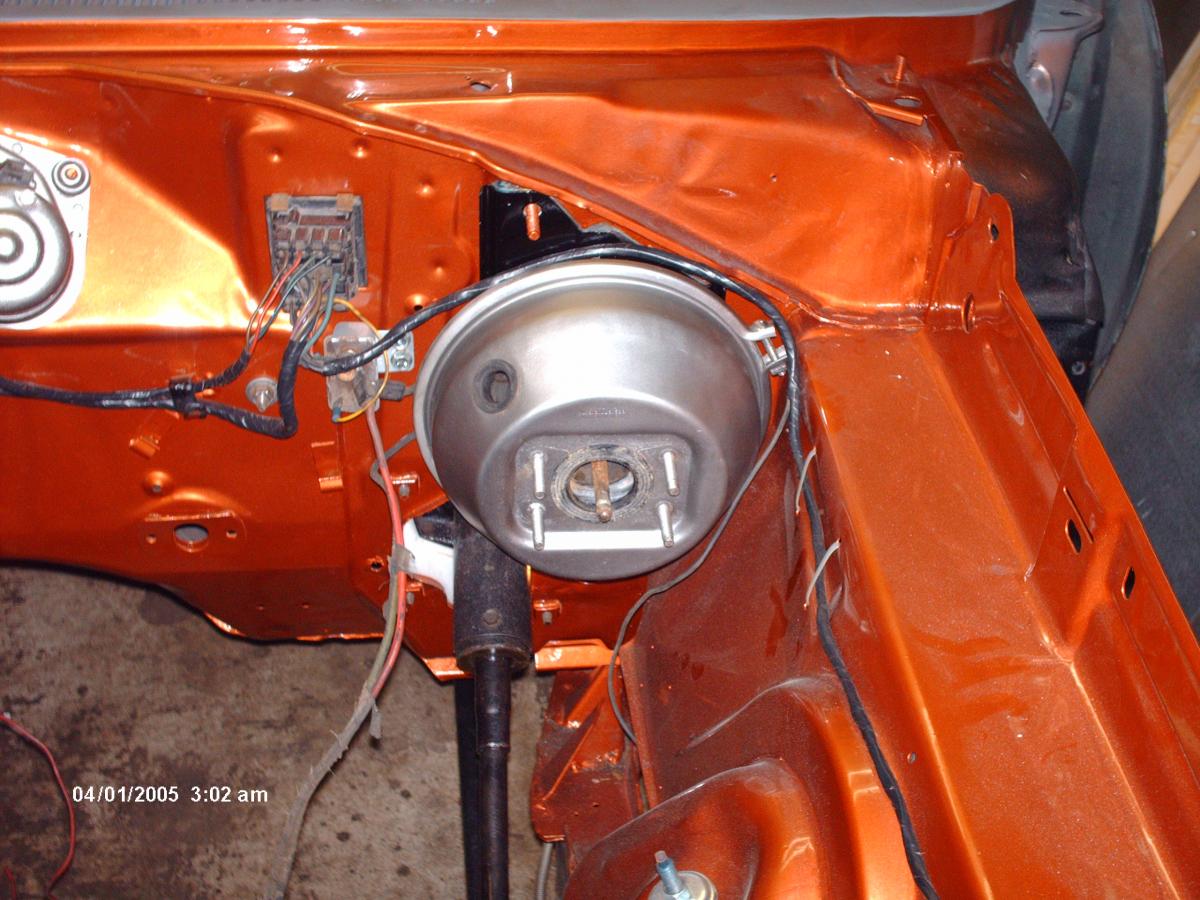

booster on the car

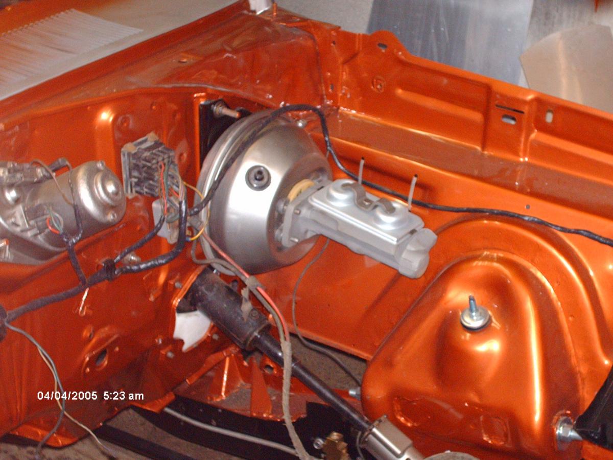

booster redone and on the car
