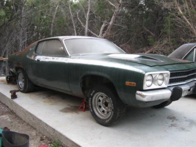

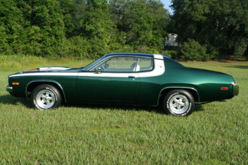

Here are a couple - my favorite hood too. Wish someone would do some of these hood bulges in fiberglass, I'd put 'em on everything. That bulge with the nostrils burned into my brain back in the late '70s when my cousin had a red '73. This is my dream car even as it sits. :icon_eyes: I can't wait to get working on it.
I do music/guitars for a living and cars for pure fun/mental health on the side.
The 'Runner is a 74, green & green, no AC, no pwr brake, roll-up window, AM radio, bench seat, 3-speed manual 318 car. Zippo for options! Needs everything, came out of a North Texas barn via a buddy in Oklahoma.
