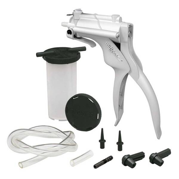

Eastwood has a bleeder that's not too expensive and makes it possible to bleed the brakes yourself. Handy tool in the box IMO
There are other more expensive bleeders out there but unless your making a living doing this kind of work, this tool will get it done for less $$.$$
Mityvac Brake Bleeding Kit
Item #49040
$46.99
