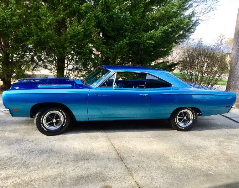

Got ‘69 road runner. Currently, 14” magnums on front (original ‘68 w/chrome edge) and aftermarket 15” magnums + 255/60 tires on rear. Want to put rear 15”s on front and go with new wider 15” magnums on rear. What is the widest rear wheel I can fit inside stock rear wheel tubs? Buddy has ‘69 Charger with 15x10s but not sure if RR ‘hips’ are as large as Charger. Also, include tire size rec also. Thanks to all!
Should have no problem with a 15x8 with a 4 1/2 backspace. 275/60/15.
You could squeeze more but the 275 is a clean fit.
All Mopars are not the same when built.They have a plus or minus as far as clearance left side to right in most cases.
Nice RR !
