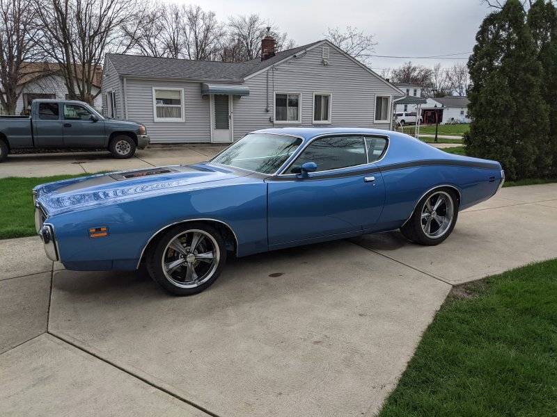

Hi all, I want to pit 18x8 front & 20x10 rear wheels on my 72 Charger, it has no modifications & I'm interested if this will work without mods?
Tires I am thinking, 232 - 245/45 R/18 & 295 - 305/45 R/20 deep dish to get a mean stance & wide looking butt.
If mods are needed I will definitely consider it, so please fire away!
I will also be getting a new diff housing with disk brakes if that makes any difference.
Cheers,
There is a lot of room in stock wheel wells pick your wheels and tires first then you can determine what length rear diff to get. You can also move the springs inboard with offset shackles from dr Diff.
