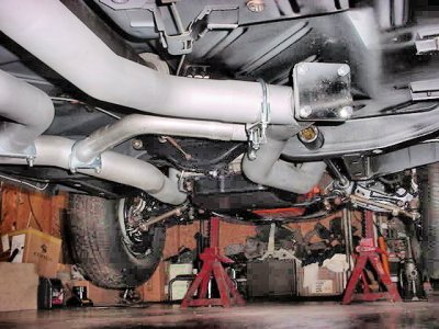

here you go tti 3 " SAM_1156.jpg tti sells 749 buy mne used 625 plus the ride

tti is your best option...nuff said.

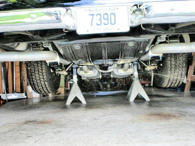

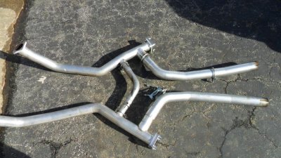

Accurate full system $1617.00 (Press bent pipes)
tti full system $1156.00 (Mandrel bent pipes)
Difference $ -461.00
For the price difference alone, I say tti is the better buy.
My originals have a pressed section on each for clearance of the torsion bars.
Do either of these manufactures have these also?
AFAIK, they don't mate.
Accurate are that - more accurate to factory spec including the reduced dia bends. TTI are less "authentic" but mandrel bent for better flow. Your choice.
