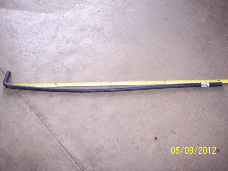

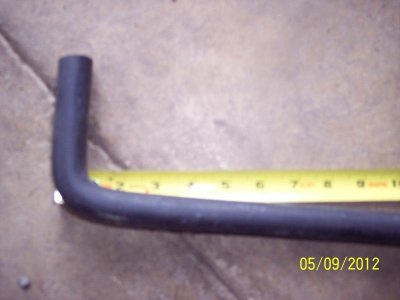

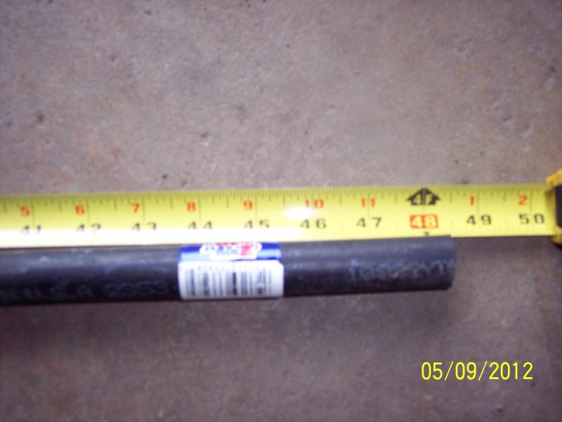

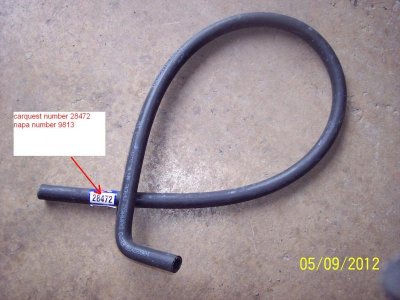

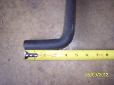

Check this out and you don't have to mortgage the farm!!
5/8" 4-5" on the short side of the 90 degree and 48" to 52" on the long side
should get job done without any trouble.Can be had at your local Napa and it
is a Gates hose. Napa number 9813 used on Dodge trucks.Cut to fit.
Hope this will help you all out.
Jeff

Here are some pictures of the hose and the price is approximately
$17.00 to $20.00.
Jeff

Damn, those look exactly like the heater hoses from a late model dodge ram, just alittle longer.
