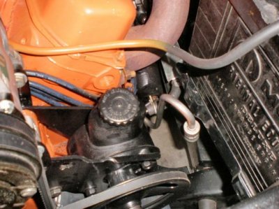

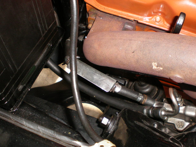

If anyone is running Max Wedge exhaust manifolds with power steering, would you provide information on the high pressure hose to the steering box. Also the fitting that is used for proper clearance between the manifold and this fitting. My car is a 1963 Plymouth Sport Fury. A photo would be great, thank you.
Nick Tiberio
FuryUs63
Hope this helps,can get more tomorrow if needed.I might add that pump is a 70 Saginaw and return fitting on steering box is also 70.
