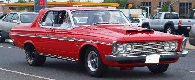

As you know these cars both have the max wedge scoops. The deal was all 63's were Max Wedges and used this scoop. 64's were both Max Wedges and Hemi's and the 64 Maxie's used this scoop and the Hemi's used the wider scoop with no dip in the middle. It's no law telling us we cant run a Hemi scoop on a Maxie car but most cars were like that back in the day. Ron
A Hemi hood

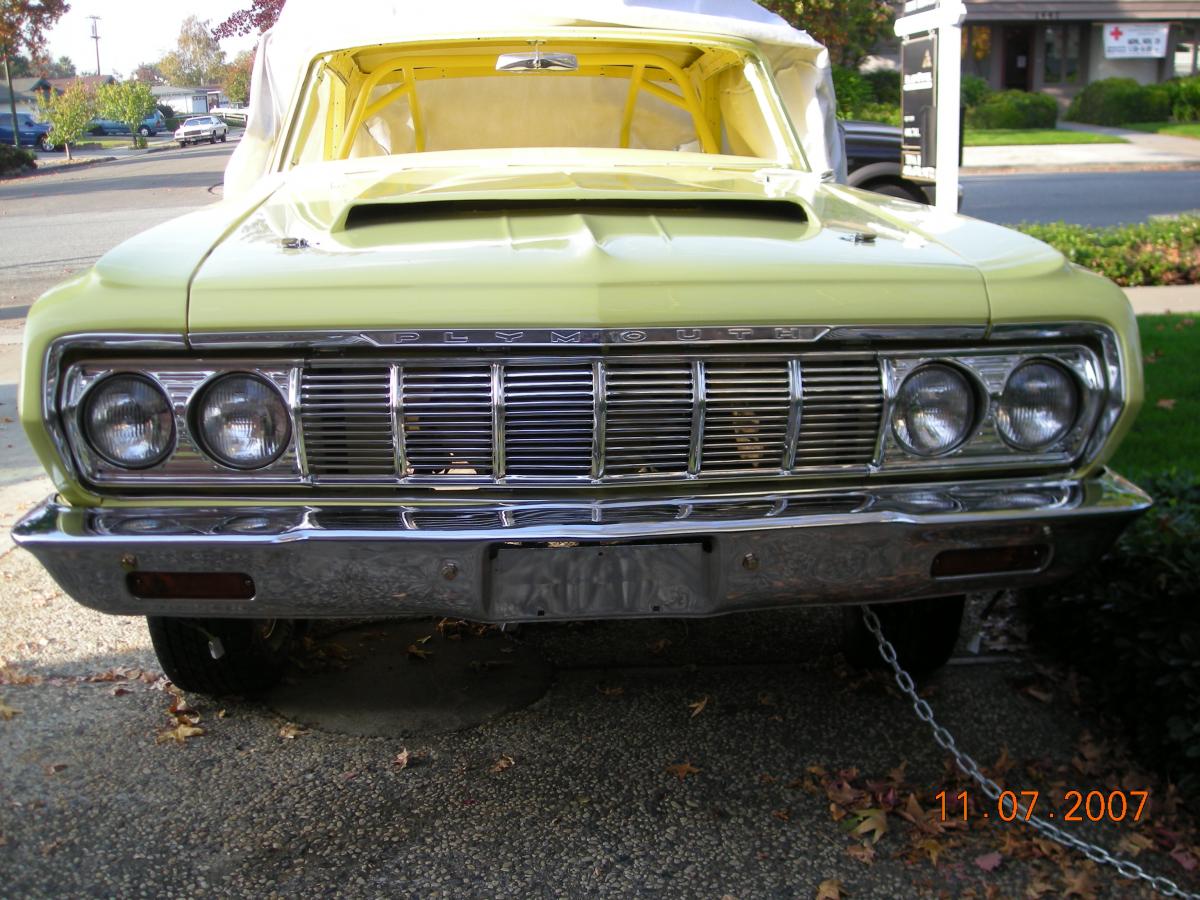

My 64 Sport Fury had the flat hood too. I went fiberglass lift off hood from some place in New York. Can't remember the name of the place off the top of my head but I think the Hemi hood looks a little nicer !!
Ron is correct. But be carefull, there are different types of Wedgie scoops out there. Not only quality but also the looks. I've seen some scoops that are higher...I don't know which ones are correct, but the picture that Ron posted looks correct to me.

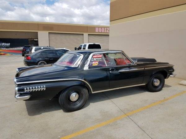

bad pic but its a little bigger than stock I got it at spring fling here in the san fernando valley ca.
