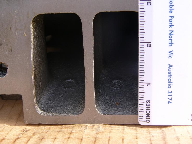

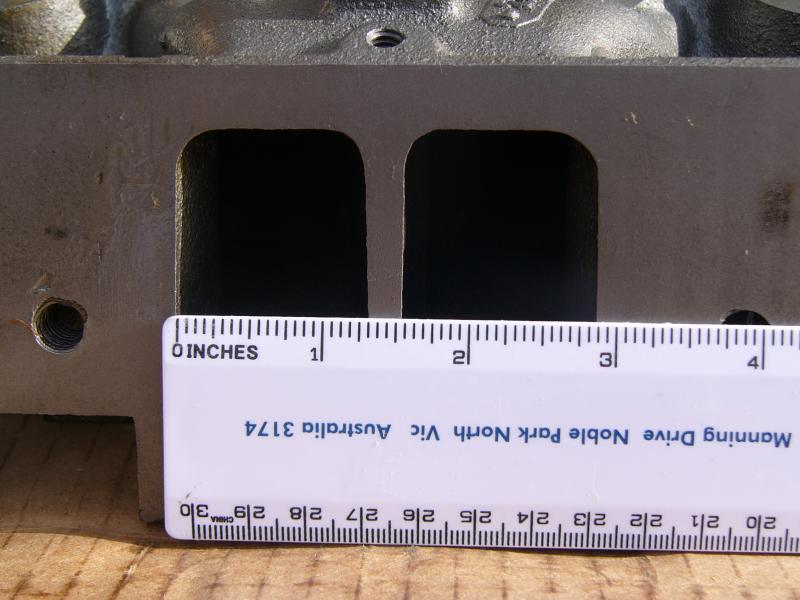

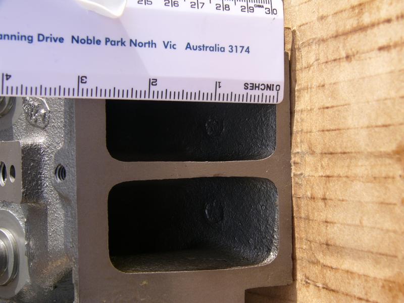

Does anyone have the sizes of the intake ports on a stock 426 max wedge head? I can only find the volume of them, I need to know how tall and wide the openings are.

Hmmmm, maybe get an intake manifold gasket for a max wedge if you are trying to open a set of standard port heads up.
The Max Wedge head ports are roughly 1/4 taller that the standard head. Width is the same.
I'll post a pic but first ill have to get mine from storage.stand by
1 3/8" wide by 2 5/8" tall
Thanks Theman, I wasnt quite sure of the width, I might get my heads ported to max wedge size, I wanted to check if my M1 intake has enough meat on it to port match
thanks the pic will help alot
thanks Histoy exactly what I needed to know, Man, those are some big ports
Those are the dimensions of the new intake manifold gaskets.

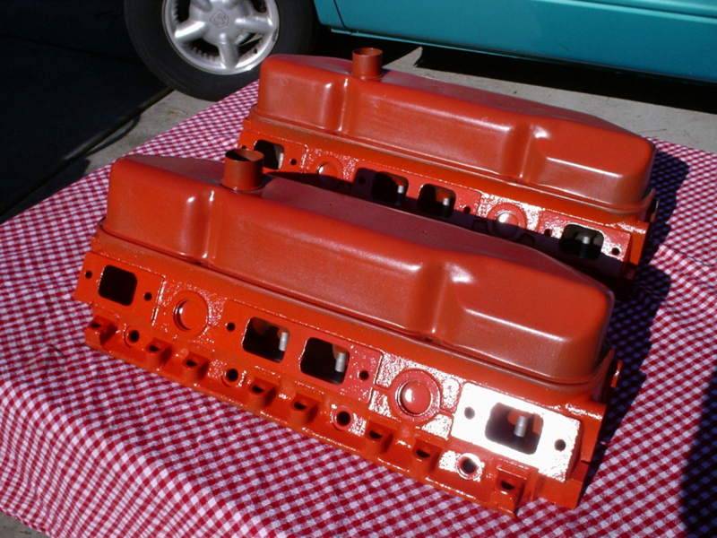

WOW haven't opened that cupboard for a while :icon_bounce:
stock heads 286's been stored since 64
Since 64? WoW beautiful piece of history
didnt hurt to try, I'd use um once a year at Christmas as center pieces LOL
That's a hell of a center piece...
