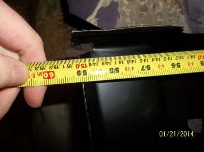

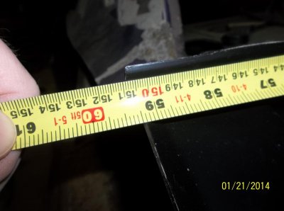

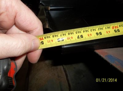

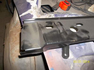

Am attempting to make my rear cross member. So far so good. Want to know the minimum length of the X member. How far past support bracket that is welded to the X member does the X member go. This is with out the corner brackets.
I want to trim off some of the excess length. Have got an idea of length from photos, but want a better idea.
All help appreciated.
Tony
Hi Tony,
I assume that is the crossmember that the rear bumper attaches to. I have one that I purchased from AMD, and here are some pics with measurements. I hope this helps! 100_0592.jpg100_0593.jpg100_0595.jpg100_0597.jpg
