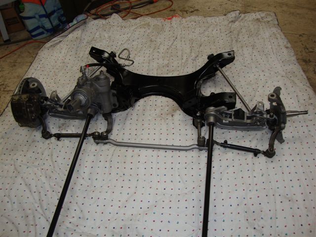

Trial fitting for the 69 RR....and strangely enough it all fits :grin:
The brakes are the 11.75" with the tall spindles and I will be using tubular upper A arms. Note: The tall spindles are not recommended with the OEM upper A arms.

Nice! Is the K member powder coated or sprayed? Reason I ask is that is next on my agenda now that I finally got the engine painted.

J/K. That's looking real killer. Who's arms are you using?

Upper arms are Firm Feel. I didn't care about them until they said the arms have an extra 4 deg of positive caster built in and will allow the use of the tall spindles. Sold!
K member is sprayed SEM hot rod black. This is a three part system that comes in a box. It seems to have the right amount of gloss and I plan to shoot the rear end housing with it as well.
The steering box is painted with cast blast from Eastwood, but I'm not sure if it's supposed to be bare iron or painted black. Easy enough to fix.
Thanks, but the steering box is still bugging me. Should it be black or natural cast?
I don't know which way is "correct." But if it was going in my car, I'd do it just the way you have it in the photos. Whole thing looks good :sSig_goodjob:
