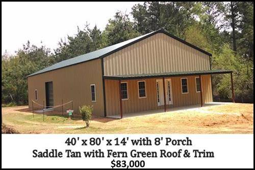

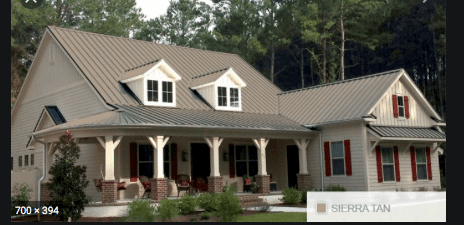

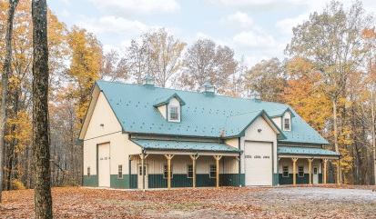

Some metal buildings look very commercial/industrial, but what about these?
The red one above, but with a 14' tall wall would have cost me $22 per square foot in 2018; and is insulated. Electrical and HVAC is extra. Steel prices went up in 2018.

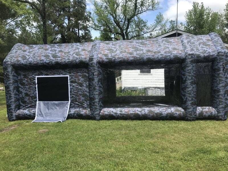

I bought an inflatable paint booth which I would strongly recommend because it cost less than what it would have to buy vent fans for the shop I built hope this helps
Can u send more picks of the booth if u have them and what’s the cost of that booth. Ventilation in the booth I’m assuming.
These are fine for a single quick splash job BUT what happens when you deflate it? being plastic there's going to be a lot of static and any dust or overspray is going to get on the walls and ceiling and fall into your next job.
The price of the booth was right at 1k
I have not had any problem with dust or overspray if I do I can pressure wash it or buy another one and still come out cheaper than building a booth.
It has positive ventilation with filtered air intake and exhaust. The only complaints is it’s super hot in the sun and lightning. I do worry that the power will go out while I’m painting but I made light stands that will support it if it falls. To date I’ve done 5 good size jobs in it.

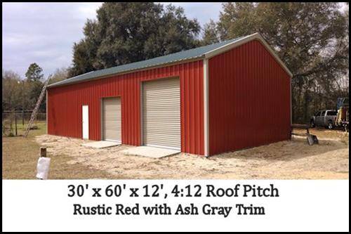

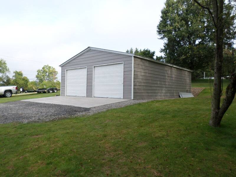

When I was looking at property I was also looking at buildings.. (Guy Thing) after looking at allot of designs I settled on metal 30x70 (2100 SF) four roll up doors on the long side... I planned to put dividing walls so there would be a paint area at one end, a section for my lift & mechanical repair plus my lathe & mill... then a larger area for finished cars....
As far as metal vs wood, I see no reason to even consider wood... As far as looking to industrial, a little faux brick or lap siding can totally change how a metal building looks...
