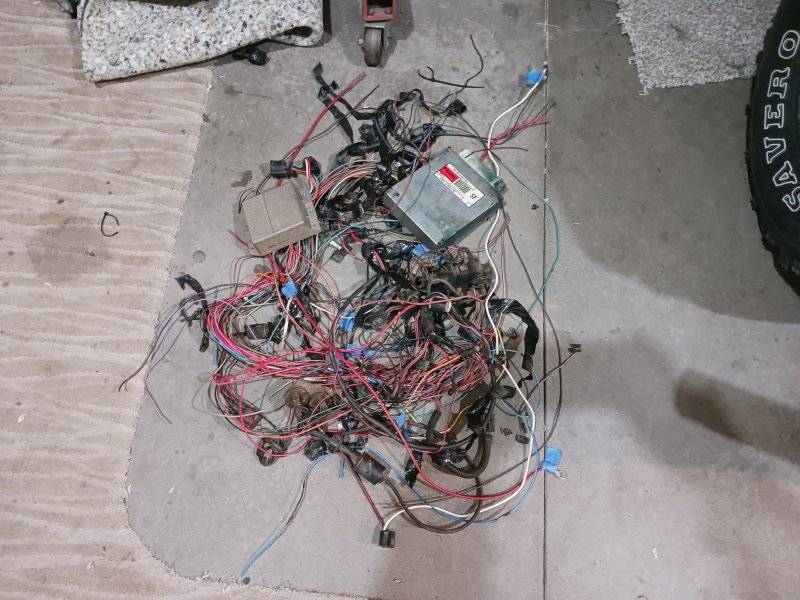

I bought an '84 CJ7 at the beginning of the year. Rust free and 300 miles on a rebuild! I couldn't pass it up. The more I drive it the more I love it! The guy said there is nothing wrong with it but I soon found all kinds if **** wrong with it! The headlights were cutting out on the drive home, heater and dash lights didn't work. I had no idea how fast I was going on the interstate. The doors flapping in the wind and tire noise were really loud. It was a white knuckle ride! It was and still is a major distraction from my GTX. That's what I don't like about it. The pile of wires is everything I removed from the engine bay. The frame rails tend to rust out between the rear wheel well and bumper so check there. I wouldn't buy one if it's a rust bucket. Who needs that headache? After months of fixing various things it's a very fun work vehicle!
