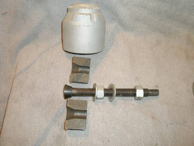

I need a Miller C-4087 caliper piston puller to get my single piston Kelsey Hayes calipers apart. The pistons haven't been moved for 30+ years so air isn't working. I see a lot of these tools listed on ebay but they are selling only the outer piece. I need the whole setup in the picture.
