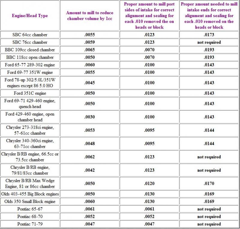

no prob on cut that ammount on heads though. just take in mind the heads intake face won't align perfect with intake, so will need to be cut too.
as far I recall, for each 0.010 of head surface intake head face must be cut 0.012 too... or something like that. Not really important if is just a shave over the head surface ( or head gasket thickness change ), but bigger cuts will require to note that
Yup, use the factory style steel shim gaskets. They come in right around .020 thick and go from there. Most shops don't like to mill much from heads and usually take enough to clean them up....plus it will change how the intake sits on them too but I've taken .040 to .050 before without any problems. Do a mock up on the intake before milling it or the intake side of the head.
You should be very careful milling the heads. One thing you haven't mentioned is valve clearance. Things will get tight with high top pistons, especially if you have oversize valves. I have always shot for zero deck and flat top pistons.

I would Definitely make the other alteration to the intake side of the head and not the intake manifold.
Use the steel shim head gasket, then you will only need to mill the heads and/or block a total of around .040". I once built a 440 using the KB quench dome pistons, and had to cut the heads about .030 to get to .035" dome to head clearance. It worked great!
As for that chart, I always do a mockup before cutting anything. In a perfect world, the chart is right......but.....
