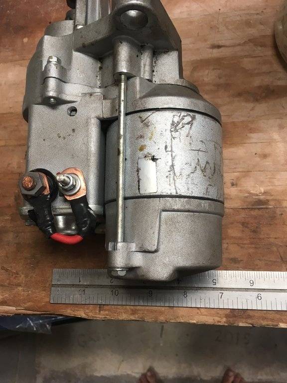

Here's basically a 440source starter... typical eBay starter. Looks like 5-1/8" across.
This looks like the same one but I bought mine somewheres else.

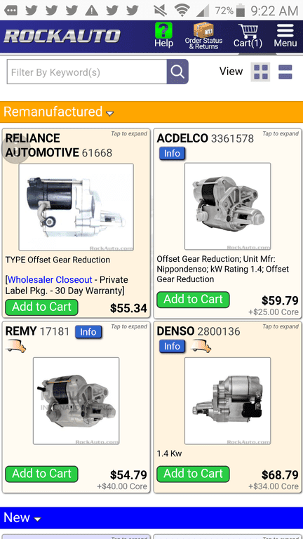

Rock auto has a nice one ,look it up under your car in the starter section.

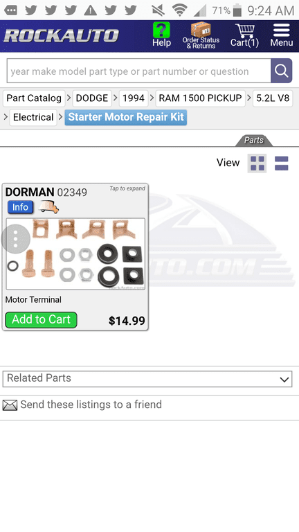

Look it up under 1994 dodge truck magnum V8. check ebay, or check junkyard. Only thing that goes bad with these really is the brushes, and contacts in the solenoid get dirty and req cleaning. The solenoid end cap unbolts from the solenoid contactor easily to clean up these contacts. Really robust and easily rebuilt unit. Plus theres a ton of em out there. They put out i believe 2.5 HP compared to 1.8HP of the original big block starter, and sound much better doing it.
