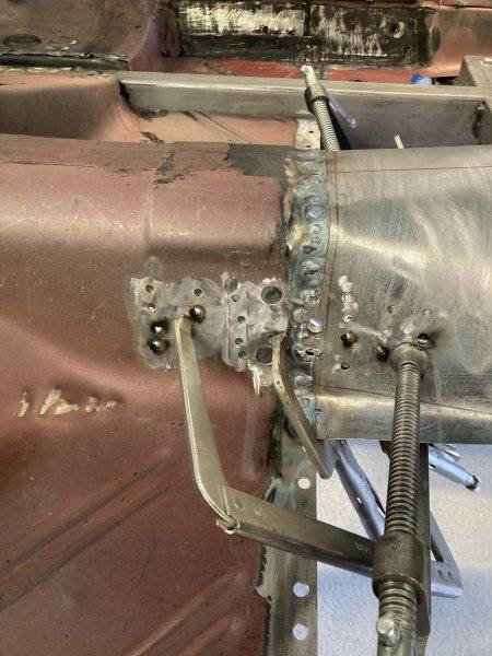

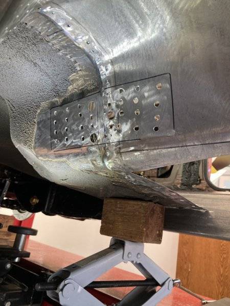

The factory seat belt location is circled in the picture with the floor pan the other one is a picture of inside the wheel tub. It has AMD mini tubs in it and that hole that is circled is now nonexistent.

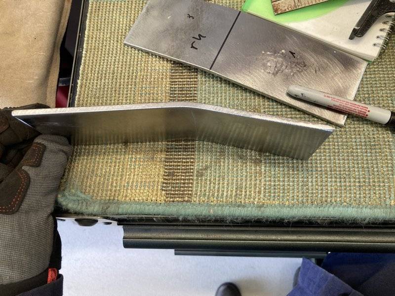

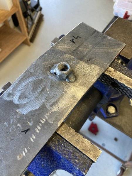

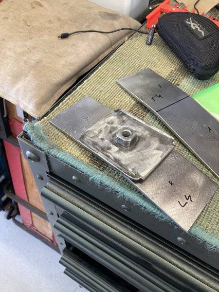

Ok. I see it with what looks like spot welds, floor to the rail, in line with it plus more welds towards the center of the car about 3" or so away from the outer ones. Maybe you could this: form up a piece of 1/8"x 3.5/4" material that follows the rail contour. Maybe make it 6" long, hole in the center with a 7/16 fine lock nut welded on the back side of the strap, trim the long edges down to match the width of the rail, drill some 5/16" holes about a 1/4" in from the edge like an inch apart so this piece can get welded to the flanged edges of the rail, mark out on that area of the floor that would be just in from the old hole, cut that portion of the floor out, place the piece on the rail, weld it to the rail using the 5/16" holes, weld the cut edge of the floor to the new piece so the floor is re-attatched. If your rails are like mine, its 14ga material so its nice and thick as opposed to the floor which if its like mine is only 20ga. On the units I made for my 65, I used some 12ga cold rolled material, it's what I had in stock[ .105 thick]. 10ga is .125, didn't have any plus I didn't want to buy any, just use what was handy. The 1/8 hot rolled material can be had easily enough at hardware stores or metal suppliers in small quantities, cold rolled is in sheets. Maybe others will chime in with more ideas.
