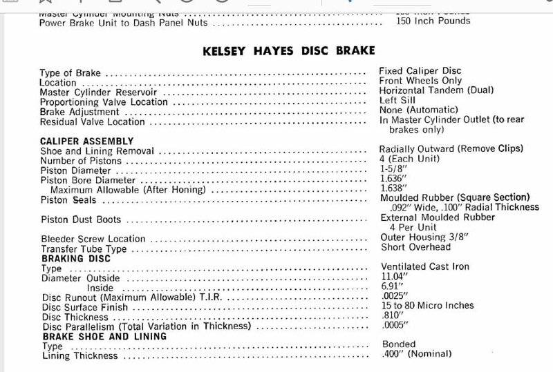

Out of 70 SM are these the right ones?.810
KH 4 piston calipers, is that what you have? I only see the single piston, 10.95" rotor which has a discard thickness of .94" in 1970 B bodies

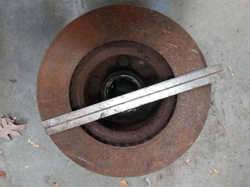

single piston, floating caliper type; 70 coronet, I assume the 1.000 -1.010 thick ones; I don't see a minimum listed there ........ they are smooth, just a bit on the thin side...... pulled from a driving car to swap in alterKtion setup a few years back....it would be nice to use them as opposed to chinesium
If it's 11" (10.95") then .94 discard
If 11.75" then 1.18" discard
Might be cast on back but usually stamped on edge of rotor
The single piston 11” rotors on my 71 say minimum thickness 0.940”. Mine measured 0.980” and 0.972” before I had them refaced.

holy crap, I will add to the confusion
I bought these for my 68 GTX about 15 years ago...... they measure about 11 1/8 across..... min thickness .866 ...........
are these the right ones for my 4 piston calipers?
and it appears they are the same as the ones that came off the 70 coronet with the single piston calipers

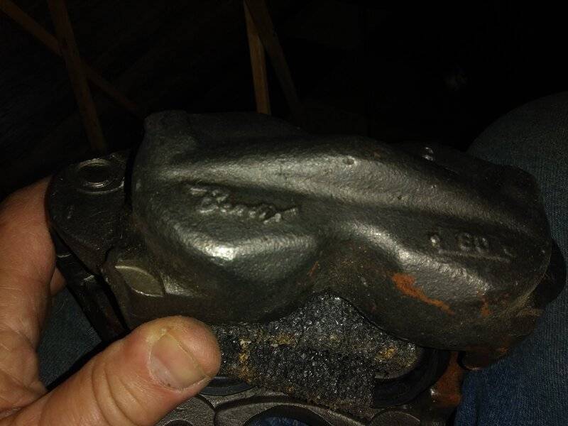

my 4 piston calipers for my GTX are Bendix.... I don't see them in the above chart.... and will they work with the unused rotors I posted?
the rusty ones i was hoping to clean up and use on a 70 with single pistons....... they were in use, but appear to be too thin anyway.... now I'm not even sure if they are proper for the application
