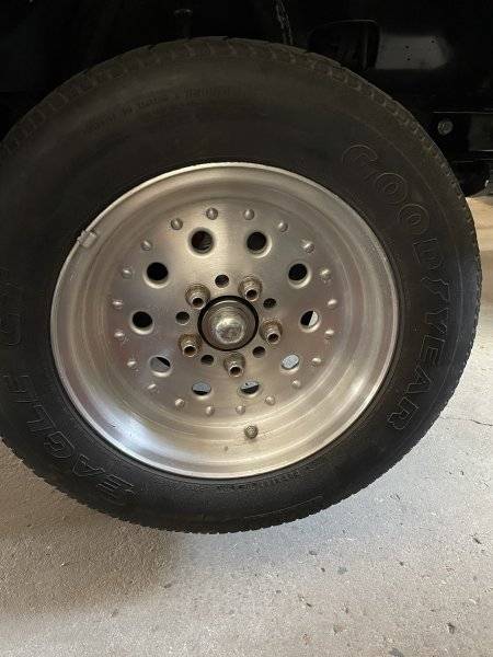

I have an old set of what I think are american racing aluminium rims without the center caps. The rear tire size is 275 R60/16 and the front tires are 215 R65/16. I'm looking for some wheel caps and am overwhelmed with options. I'd be happy with plastic but not sure of the sizing. Any idea how to go about sizing them correctly?

I would start by measuring the dia of the hole.
It's 2 7/8". The front clip is how I bought it, it has since been replaced, still awaiting paint. :D
Centerline 2 7/8 snap-in center caps. Google them. (I thought they were centerlines looking at the backside, but the front doesn't look right.)
I am thinking Satin finished Centerlines too. I only ever saw one other set like that many years ago. Not very common.
I d9nt really think they are centerlines (nuts on the backside, not rivets) but I think the push-in cl caps will work.

I'll check out the centerline caps - thanks for your feedback!
