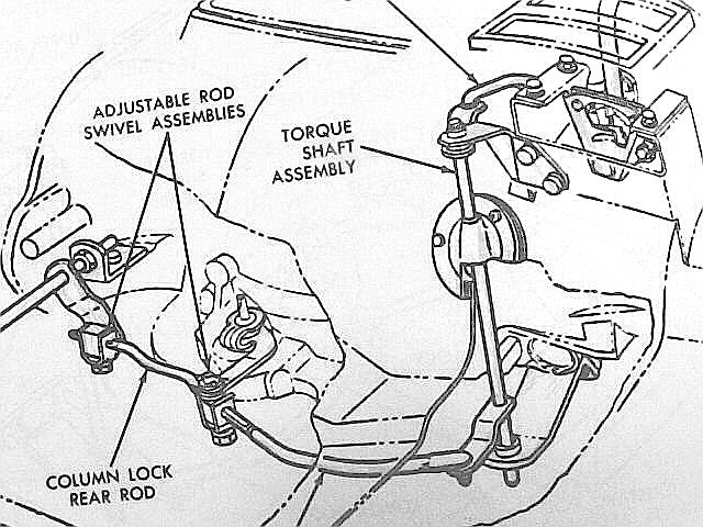

is it in this picture under shifter assembly?
long flat piece with bushing in end and other end has 2 studs that go through trans to hold it on
