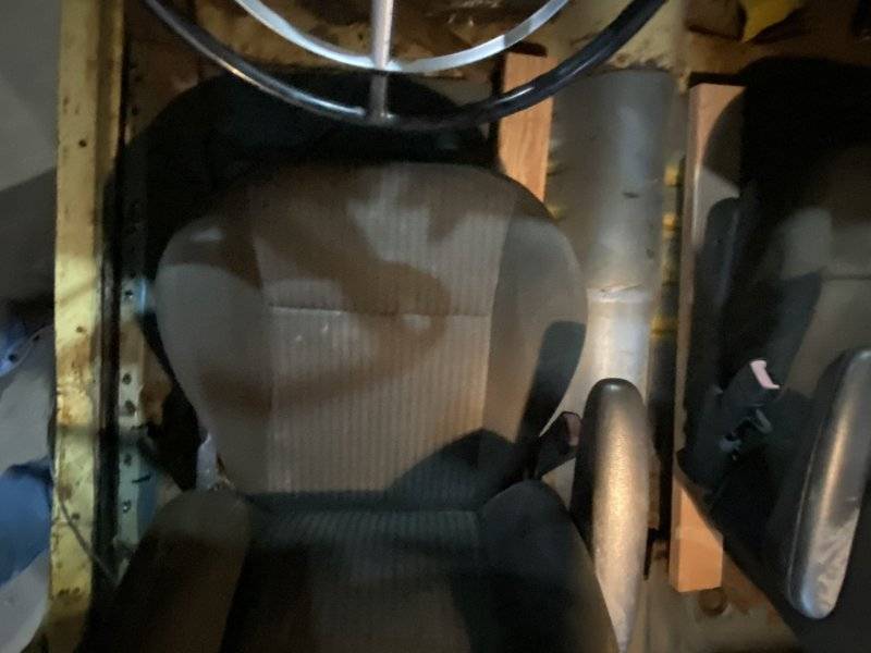

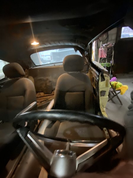

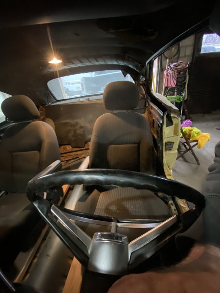

I just picked these 2006 PT Cruiser convertible buckets. They are loosely mounted for mock-up on sedan seat tracks.
BTW I will be posting a WTB ADD for another set sedan seat tracks.
