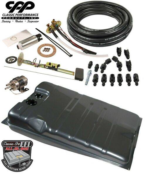

Here is a complete setup tank, sender, fuel pump, filter and all the AN fittings you need to convert to EFI. 465 bucks.
https://www.ebay.com/itm/2649684478...1291&msclkid=b7b134c83b991b9a01e856c47b6fe302
Even cheaper at Summit.
https://www.summitracing.com/parts/clp-mo6870cfit-k/make/plymouth/model/road-runner/year/1969
Thats a pretty complete kit...but again...the Gph/Lph seem lower than required.
Has anyone used these tanks with Sniper or Fitech?
The Holley Sniper supports up to 600 hp as well.
This is the CPP info.. I'm sure you already read that though.
  • Flow rate of up to 255 LPH
  • Cut-to-Fit installation
  • Supports up to 600HP
  • All metal components are yellow zinc-plated
  • 1/4" NPT supply and return line size
  • 40-100 PSI operating range
  • Heavy gauge mounting plate
  • Adjustable support arm

Does that CPP tank sender have the correct resistance or would an adapter be required?
