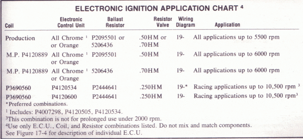

The above table explains the need for the proper coil for the application. I note that the orange and chrome boxes need to have the proper coil. The blue box with the recommended coil goes past 7000 rpm no problem. The P4120534 must be the gold box. Current day electronic components should be superior, but you just never know what the quality is. I have some antique parts i should sell since they're equal or better than you can get today.
