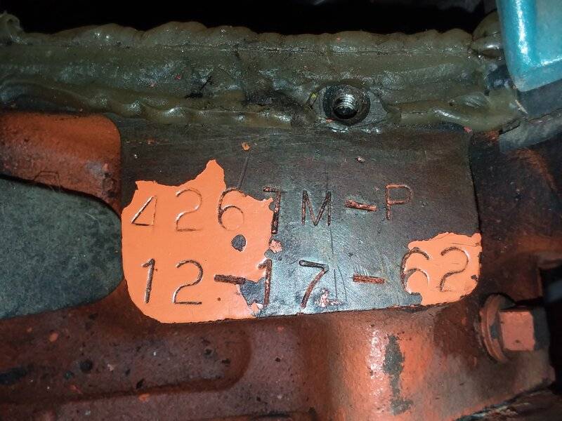

my block says 426tmp, and the front of the block is AAQA ?? THANKS ED

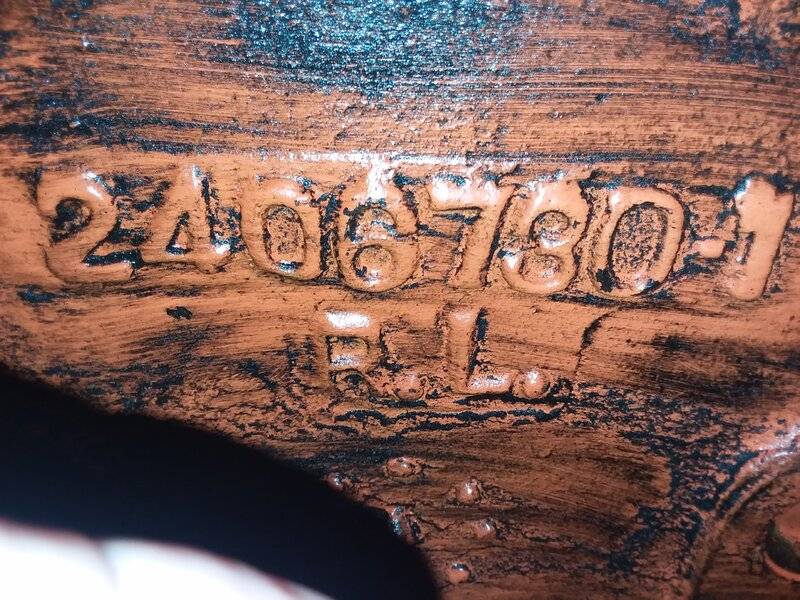

@Edward Zeliesko Sure its not 2406730? If it is, ive got good news. (If its bare, or shortblock, look for valve notches on the exhaust side of the bore)
2406730 is a 63/64 maxwedge block.
2406730 – 1963-1965, 426 RB-series big-block , Wedge/Max Performance Wedge

2406730-1 is a 1963 426 TMP Max Wedge (low compression 11.1) engine block.
What is the date on the side of the block?
The casting date will tell you when it was manufactured.
What else is stamped on the engine pad - should be a month & date stamped there as well.
The date on the engine pad will tell you approximately when it was put into a car.

can you tell the cubic inch from the casting, mine reads 2408780-1
We cant find that casting number. We are trying to tell you to look at it again, maybe wash it better. We think you are misreading the three and the six as eights.
2408780-1
2406730-1
It's probably a #2406730 which is a 63-65 426 wedge/Max Wedge block. I don't see any numbers #2408780 in the book.

426 TM-P = Is a 1963 Stage I Max Wedge low compression 11.1 engine block
9-14-62 = This date is when it was assembled to be used in a car.
So yes, it is a early 426 Max Wedge engine block.
I have a 1963 426 TMP engine block and I have a 426-2 TMP HC Max Wedge block. (Which is in my 1963 Plymouth Savoy (June 1963)= a Stage II Max Wedge.)
426 TMP is a early low compression block 11.1 = Stage 1
426-2 TMP HC is a late, after May 1963, high compression block 13.5:1 = Stage II
I hope that this helps you.

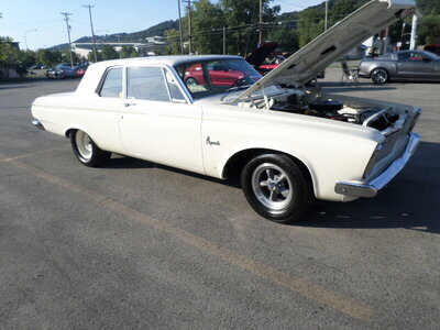

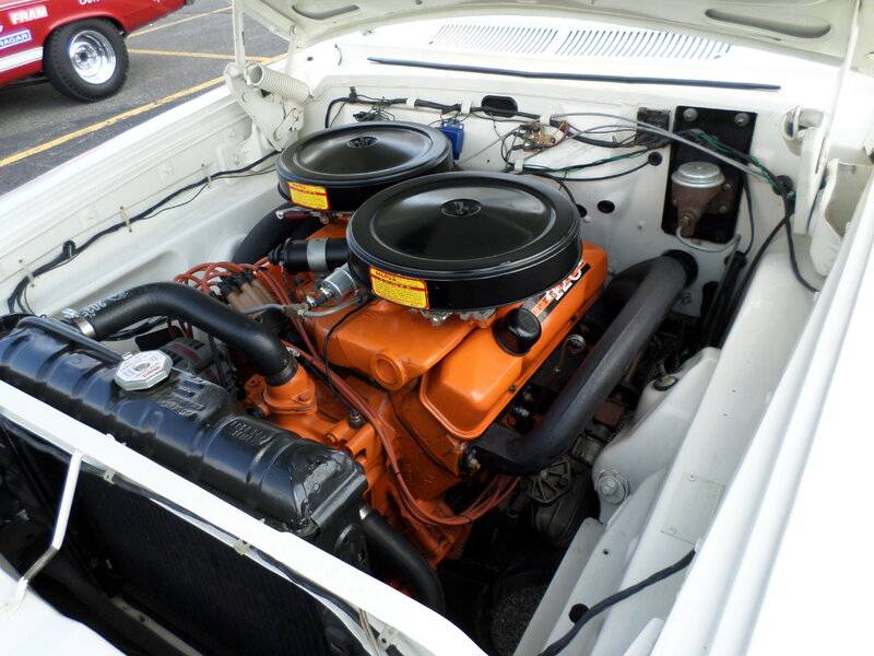

Best to you and in selling your 63.
By the way, nice looking 63 Maxie.
