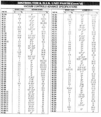

Hey Guy's,
Where can I find a new vacuum advance for my Mopar Performance electronic ignition distributor for a 69 383? Also when you buy a rebuilt point distributor for a 69 383 where do they get the vacuum advances they put on them. I would like a new advance for my old point dist. I bought 2 NOS advances in the last 7 years and just sitting in the boxes and not being used the diaphragm goes bad and the then it doesn't hold vacuum.
Thanks, Dave
I bought mine at Summit Racing. If you recurved your distributor, here is a list of vacuum cans and you can pick one with how much advance you need
I get mine at Napa, they still have the old books with pictures of the advance cans along with part numbers ...
