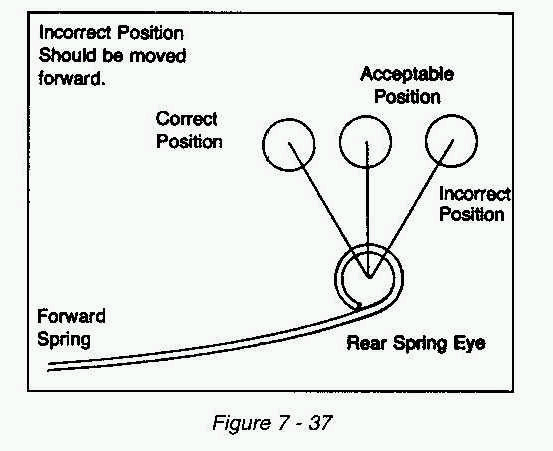

2) The rear shackle angle is important, for the spring wind-up to work right, and not put 'em in a bind. There's kinda a range that's okay, once mounted up, and back on the ground, the rear shackles need to be at 90 degrees to the spring, or more. Means the lower bolts need to be aft of the upper shackle bolts, if that makes sense.

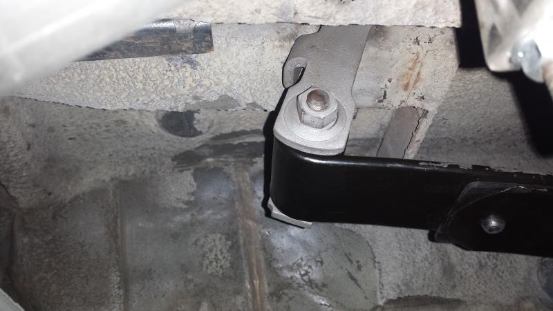

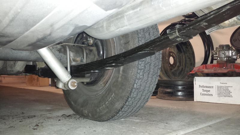

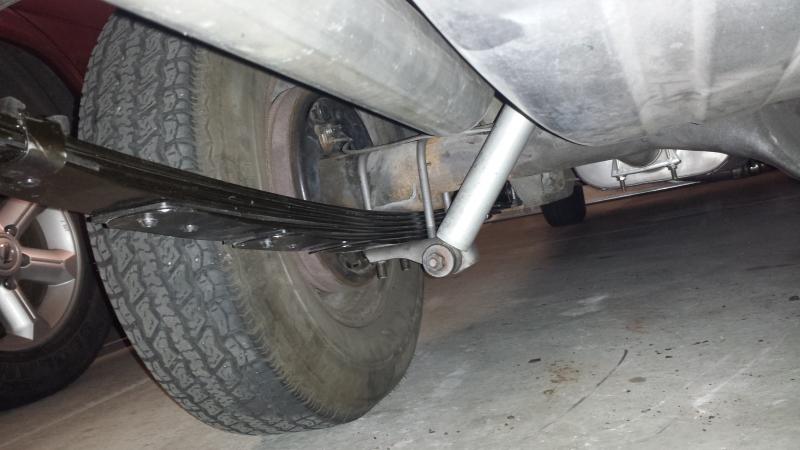

Thanks for the help. I have the new springs in and have a question. I'm using the stock rear shackles and they have a tab that looks like a limiter stop for shackle rearward travel. Right now they are touching the frame. Do I need to cut it off so the shackle has more rearward travel? The shackles are at a good angle with the lower shackle tward the bumper. I haven't tightened all the bolts down yet but it is on the ground.
Threewood...no...does not sound right. Are you saying the rear shackles are toward the rear, almost level with the frame?
Was there any kind of instruction sheet with the springs? Should show you the mounting angle limits. Something is wrong.

These might help a little...
Something to keep in mind on SS springs, their designed for spring 'wrap-up' control, used along with a pinion snubber.
When you 'hit it', the rear axle tries to twist, the snubber comes up, the springs wrap-up, and that rear shackle angle allows the needed movement. That movement is normally spring pulling the rear shackle toward the front.
Thanks Miller. Yes, they are setting at the correct angle. But the stock shackle has a steel tab that holds it at the correct angle so it doesn't go any further back if that makes sense.

These pictures are all at ride height. U bolts torqued to 45 ft/lbs. Love em so far! These are the 456 and 457 3400lb springs.
20160129_224008.jpg 20160129_224022.jpg 20160129_224033.jpg 20160129_224055.jpg
Ah...okay. To be honest, never have seen shackles like those, so don't know the reason for those tabs.
I'd say if you think you want those tabs off...cut 'em. Anyone else chime in? Ones I've always had were plain jane two piece, stock shackles. But, if it ain't broke...don't fix it! Your call.
Otherwise...cool! Looks great.
Funny thing is, my first car already had SS springs mounted up, 63 SF ragtop. Have had SS springs on just about every Mopar I've owned.
I must say I have never seen that on the shackle before and have owned dozens of early "B's".Hummm ?
