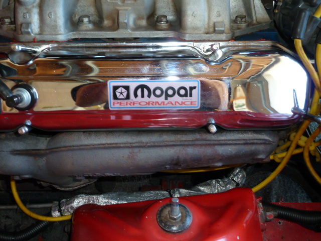

Hi, thought I'd do a nice quick job yesterday & fit the new Mopar Performance cast alloy valve covers to the 440. Passenger side won't fit though as it seems to be just hitting the exhaust manifold meaning a tab on the manifold needs grinding off. I lost enthusiasm for this so for now have put the old covers back on (photo of old covers). Anyone else experienced this? This might be the catalyst to get headers made which I've been thinking about for a while - will lead to some expensive valve covers though! Any suggestions to fit these covers without grinding anything? Cheers, Andrew
Well, if you only need a little room you can possibly add two of those metal gaskets per side and seal with high temp RTV. I have never used them so don't know how well they would stack but might be worth a try. Has the manifold been surfaced excessively or surfaced at an angle (i.e. bad job)? Maybe compare to another one?
I have those valve covers "as cast". The passenger side was very difficult to bolt down and the distributor needed to be removed to install.
