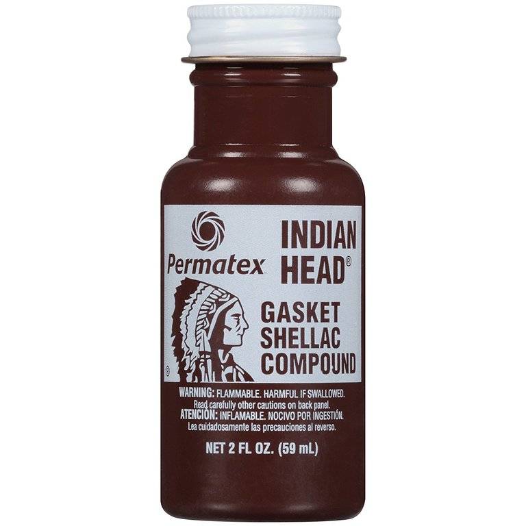

Hi, I use Indian head shellac
on the bottom of the valve cover. Let it tack up.

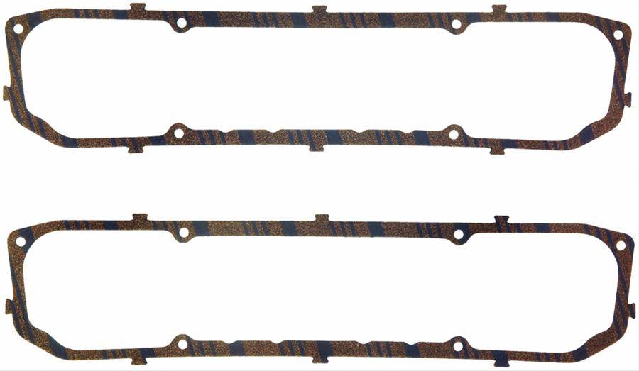

Use Fel-Pro Performance 1610 Blue cork/rubber gasket the ones with the blue stripping.apply the gasket to the valve cover .let it set up good.allow time to dry before starting the motor

I was looking at reviews on Summit and I think without the cutouts for those retaining tabs(you don't have?) that the 1612's wud be better? Haven't changed for over 20yrs and looking to do it soon. I also only glue to the cover.

Hi, I use Indian head shellacView attachment 492736 on the bottom of the valve cover. Let it tack up.

Bingo. I've been using Indian head for over 45 years

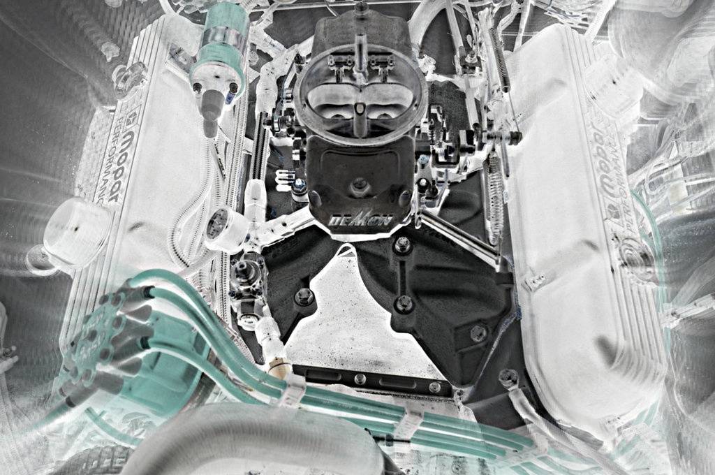

I have had good luck with the Moroso Perm-Align Valve Cover Gaskets 93055 (Rubber with steel core) and use out of the box...no RTV...no leaks yet. They are about $45 a pair.
If I ever have my heads off again I'll mill the valve cover sealing surface. It's hard to get a good seal on a shitty casting.
Never really thought about it but if you have casting flaws I'd be looking for a thicker gasket. Perusing(?) the Summit site I noticed several different thicknesses available.
