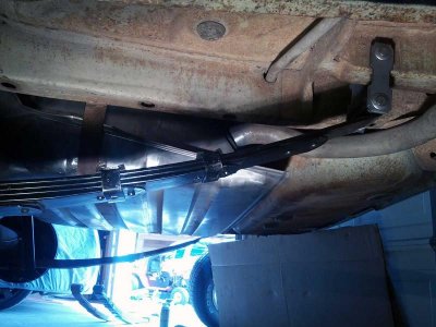

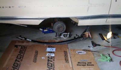

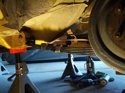

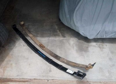

Installed rear leaf springs today. I have to say, this is the biggest improvement to this car to date, I cannot believe how much of an improvement its made over the old leafs, the old ones reminded me of driving on a wet sponge.
These are so much better, not too stiff, the ride is still comfortable and not rigid, just allot more stable and does not have that floating feeling I had before.
Got them from Summit mopar performance $225 delivered to the door, not a bad deal at all I thought.
Right: http://www.summitracing.com/parts/dcc-4452982
Left: http://www.summitracing.com/parts/dcc-4452983

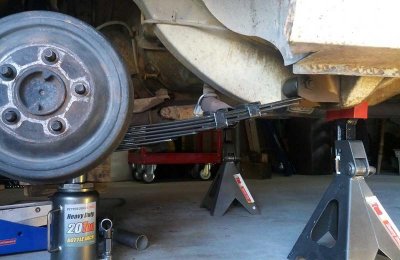

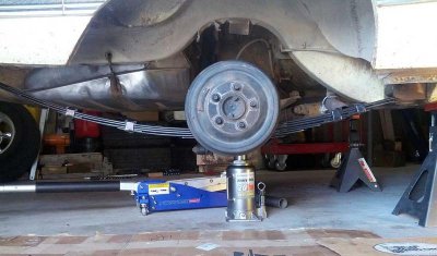

Install was fairly easy, hardest part was getting the U bolts off, the rest was not bad at all.
Here's some pics.

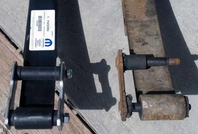

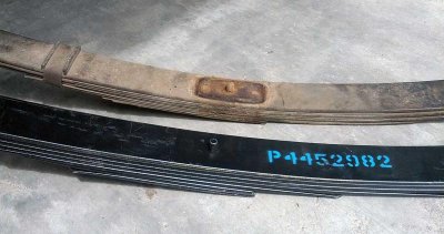

My old springs were 5 leaf, these are 6 leaf
It did raise her slightly, nothing out of the ordinary I don't think
