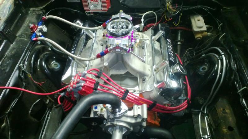

i am collecting parts for my next build, so far i have a paul rossi prepped super stock 440 block, its a 70 hp. i also have a ultrdyne roller cam 745 lift dont remember the duration off hand. my plans are for a 496 stroker in the 11-12 to 1 ratio, the cam was given to me so if it does not fit the plan then it will not be used. i dont want to piece meal out my current 440 to use parts on the new motor. i would like to build a solid 9 sec piece. the car is a 67 satty dana rear w/ mark williams 35 spline axles and 4.88 gears with a spool. willwood brakes on all corners. a jim hughes built 727 full man w/ a 4500 turbo action"J" converter. the current engine is a std bore 440 with kb pistons, H beam rods std steel crank, comp 305/525 flat tappet with 1.6 roller rockers and 3/8 mopar perf pushrods and ported 440 source heads, they flow 278 @ 600. mopar M1 single plane with a proform 850 race carb. all msd ign using the 6AL-2 WP_20131012_007.jpg
