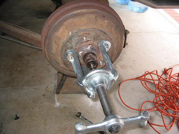

anybody do this conversion? i ordered up the parts from napa. any insights? see link for discriptoin
http://www.crankshaftcoalition.com/wiki/Mopar_tapered_axle_rear_brake_conversion
It was already done on the rear end of my 64 Dodge 440 wagon. How very convenient:)
SuperFly TNT
Got the hub and drums seperated and installed the new ez removeable brake drums. Way ez mod with your write up, going toghere just as laid out in your article Centerline. It's a roller again! thanks bigtime.
You're welcome. It is a piece of cake, especially if the hubs come off the axles easily.
