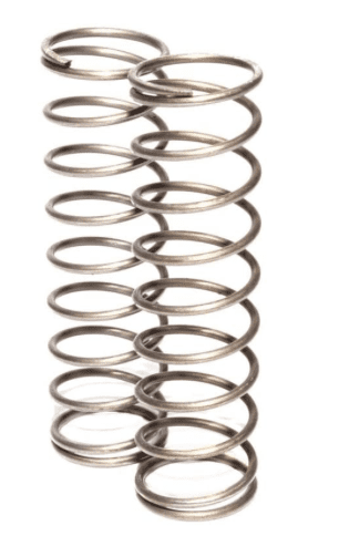

You can guess and gamble or you can measure what you have... Swap out the valve springs with a pair of light springs & measure valve travel at every 2 degrees across overlap..
