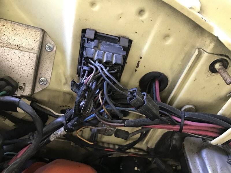

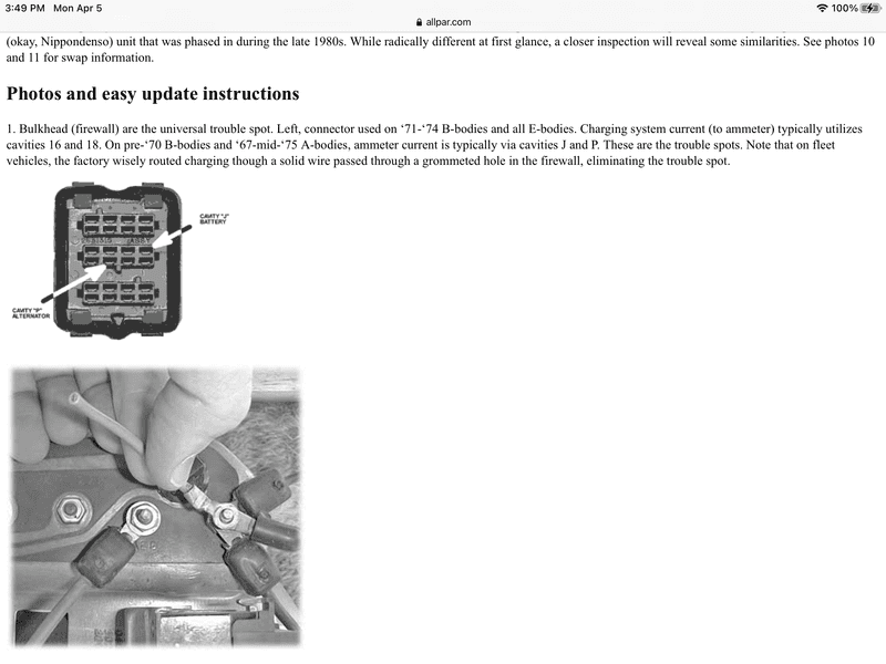

What does your bulkhead connector look like? Good tight connections, no corrosion?
For me it’s ALWAYS the Bulkhead Connector.
Thanks again, I am going check bulkhead connections again as well today.
