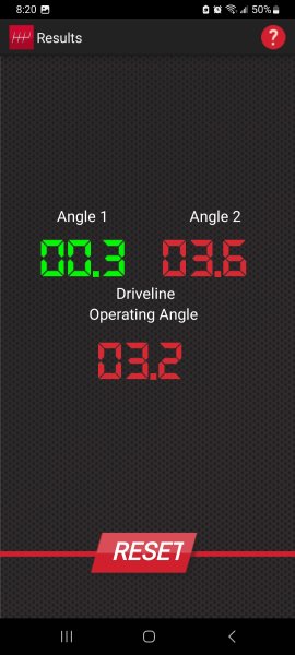

#1- trans yoke
#2-shaft
#3-pinion
I used the Tremec app. Am I reading this properly? I need to bring the trans down a degree or so and the pinion down half or so?
As simple as it is, I can't wrap my head around it, I don't think......
Thoughts, comments, questions, concerns, insults? Appreciate them all
