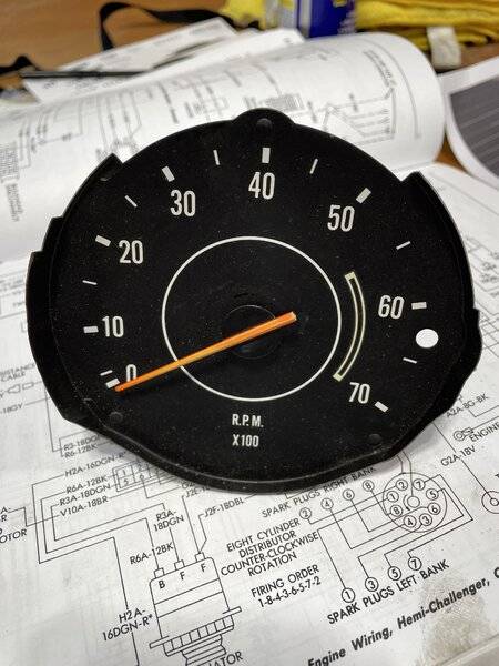

I have this tach:

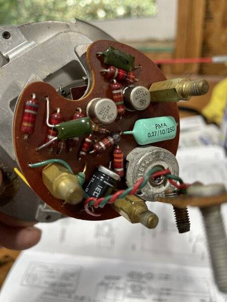

The internals all look great:
No burn marks, no charring, no smells. Only thing I notice is that the needle on the face, when I move it manually, does not return to 0 by itself, I have to move it back. Don't know if that is correct.

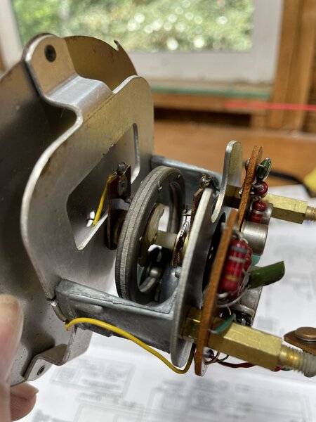

Problem found and solved. The clue was the needle not returning to 0 if I moved it manually. In looking over the information on the replacement circuit board they mentioned the needle and a small adjustment screw that affected its movement. I had to take the thing mostly apart but found the screw. The needle was too tight.
Hooked it all up to power, ground and negative coil and it works perfectly!
