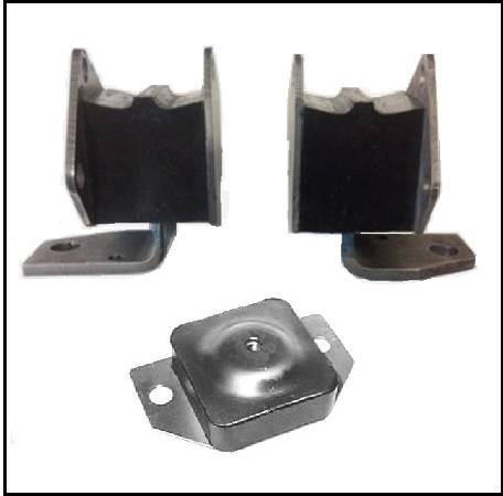

Are there motor mount replacements to fit an early 70"s model forged crank 340 into a 74 RR? When I pulled the motor Bubba had what closely resembles a lug nut taking up the gap on drivers side motor mount. There is a half inch difference from pass side to drivers, with the drivers being the smaller of the two.

AS FAR I KNOW, for some reason I really don’t know, 340/360 73 and lates engine mounts are not the same than 318s

drivers side ears are farther apart on a 340/360 than a 318.. you would need a different upper mount bracket or make a spacer (i would do spacer cause cheap) I believe that's correct..

73 and lates mounts are not two diff parts like previous years. They are one assembly

the 318/340 mount is the same, the 360 mount is narrower. NOW, I'm open to being corrected on which side of the fence the 340 is on. But I'm siding with you being the same as the 318.
Edit; think I'm wrong.. 340/ 360 the same..

ahh!!! i thought they switched to spool later... My car actually has "Floating Power" mounts... they are only $800 a pair.. now it has home-made solid mounts :)
Right side 64-69 273 and Poly 318 and 67-91 318 block lug spacings are the same. 340 and 360 left side lugs are narrower than the 273-318 lugs. Left side 273-318 will fit in place of the 340-360 with a spacer.
